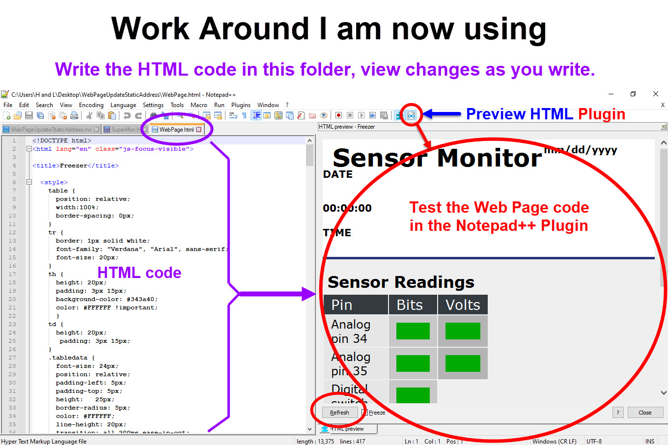

Decided to add a tab in the sketch folder and just place the HTML array in that Tab.
This is how I am dealing with Web Page code to be use in the ESP32 Arduino sketch.
Using Notepad++ to edit the Arduino and HTML code.
Write the HTML code and test it out using the Preview HTML Notepad plugin.
A short Macro deletes the Char Array in the Arduino sketch, then paste the HTML code into the cleaned out array.
This Macro can be used over and over again in other projects too.
