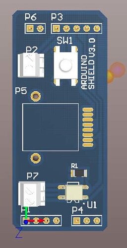

We've designed a new version of this shield that is much smaller and easier to assemble (one of the main barriers to producing more of the old one was that it was taking way too long to make each one). The new version also addresses some other issues with the older shield as well - for example we use screw down terminals to attach external wires and sensors (the previous snap-in ones were a bit of a pain), and we also got rid of the jumpers too. Here's what the new design looks like:
The main features of this new shield are:
  • An input terminal for reading a dry contact (e.g. button, relay, magnetic contact switch etc)
  • An output terminal switched by a relay: can operate other low-power circuits or act as a dry contact (e.g. for an alarm system)
  • An ethernet plug that can be attached to the Insteon PLM to send/receive insteon commands
  • A push button that can be read by the arduino for interface purposes
I'm still waiting on a quote for the first 150 PCBs of this new shield. But if things go as planned I should have a new batch of these shields in a couple of weeks. If you'd be interested, please get in touch with me at alan [at] goodrobot [dot] com.

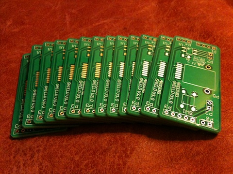

Good news! Last week I received the batch of PCBs for the new home automation shield. Here's a photo of a few of them (just a small sample as there's 150 in total):

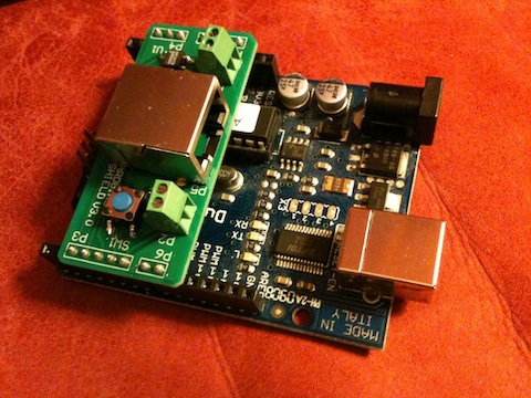

I've now assembled and tested these boards, and they work great. Here's what they looks like fully assembled and mounted atop an arduino:

One important note, for this shield to work with Insteon you will need the PowerLinc Modem (2413S).
