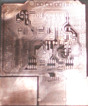

Now have a few new versions of the PCB, and all the traces are looking good. And I've attached an image of one of them:
Next step is to populate it with components for testing. I'm reasonably confident the Insteon jack will work, but the other features will require a bit more testing.

Very nice! Can't wait to see it in action.
Just a quick note to update on progress. The first couple of PCBs are completely assembled now! I've done some testing and looks like some minor soldering glitches (note to self: next time make bigger spacing and traces). There's one problem with the circuit itself that'll prevent the PGM reading feature from working on this version (this is useful for reading status from security alarm systems). But the other features appear to be working. So this board can:
  • Send and receive insteon commands
  • Read dry contact sensors (like the contact sensors from a security alarm system, or a pulse water meter)
  • Act as a dry contact sensor (using a built in relay). So you could have the arduino output to other systems that read dry contacts (Or switch LOW power DC accessories)

I"m happy to report that the new batch of 26 PCBs has finally arrived (see photo of new boards below). Shipping was supposed to take longer than this, so it actually beat my DigiKey order for the components.
To get these out quickly, I may make several simplified versions that don't require all the additional circuitry for relays, or PGM sensing (for DSC security alarm systems). That way it's just a jack for communicating with the Insteon modem, plus some terminals for sensing external devices through the digital pins. It shouldn't take me long to assemble those - I should manage to do that after I get my digikey order in. If things go as planned (I still need to test the new boards) I will be ready to ship out the first few at the end of next week.
