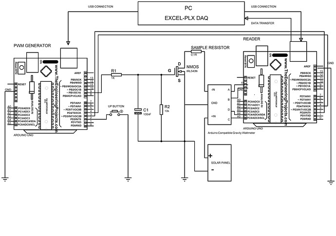

I apologize, it took me quite a while to draw the schematic. Proteus wasn't installed on my computer, and it took hours. I also had to change some pins in the software. To be honest, it's challenging to determine if the software fully meets my requirements this way. The reason is this: I want the 1st Arduino to increase its PWM signal with each step, and when it does, the 2nd Arduino should perform a single read. After the 2nd Arduino finishes its read, the 1st one should advance to the next step. In other words, I want them to work sequentially, without skipping any data corresponding to each step, without any data loss. However, because the differences between steps are very small, I can't tell if data is being skipped or not during testing. This is actually my question: Will these two Arduinos work as I expect, without data loss, using this code?

They're both uno. I could draw the schematic finally. Additionally if you could read my last answer I made some changes and clearfied my question.

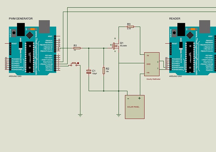

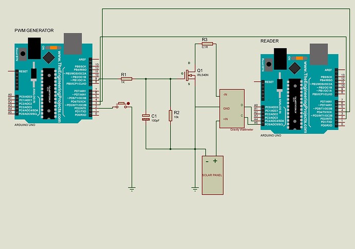

This may be irrelevant, but please give it a try. Connect the grounds of the two Unos. Right now, your signals are relying on a ground reference via the two USB cables to the computer(s?) powering them.
For your schematic, that's a nice start. However, you should always include complete information about the power source(s), and clarify whether there is one computer or more involved in the setup(when there is more than one Arduino). This is because power sourcing is one of the most common problem areas for beginners(and sometimes, not-so-beginners). If you had included that info, I would have more confidence in telling you whether you have a ground reference problem; as it is, I can only speculate.
They are powered from the same computer, but when I previously encountered issues with the operation of the MOSFET, I considered that it might be due to the reason you mentioned (I thought that not all grounds in the circuit were connected, causing a potential difference that could affect the operation of the MOSFET), so I connected all the grounds. Do you think I should do that?
Should I connect the grounds of Arduino and all other components?
As you can see, in the circuit, the component serving as the power source for the MOSFET is the solar panel. As I mentioned, when I do this, two Arduinos powered by the same computer, the negative terminal of the solar panel, the source terminal of the MOSFET are all being connected. Is this a correct application?
So you're saying the drawing in post#11 is incomplete? There is a connection from each Arduino GND to the GND of the "gravity wattmeter"? Could we have a link to some documentation for that device?

II have attached the modified schematic in another message, but you may not have received a notification because I didn't respond to you. In the initial software, the condition for the interrupt is for pin 3 to be HIGH. This pin is hardware-wise connected to pin 2 on Arduino 2, and that pin is inside a loop with a condition that requires interrupt 1 on Arduino 1 to occur and set pin 4 to HIGH. This setup makes it seem like Arduino 2 shouldn't be reading at all. However, it is still reading. I'm not sure if it's functioning correctly. How should I rearrange the pins or conditions for them to perform sequential tasks? I need help with this
See if these sketches give you a better hand shake using interrupts on both sides.
PWM generator code
I have added debounce to the button on pin 2 by reading it on a 50 ms timer. Connect stepPin 4 to pin 3 of the Reader where it will be sensed with an interrupt. The pwm generator will get a response from the reader with an interrupt on pin3 when the step signal is received.

const int readPin = 2;  //connect to pin 3 on other Arduino

  pinMode(3, INPUT_PULLUP);  //receive signal from other Arduino
