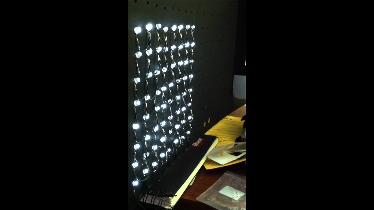

Hi!
I saw this and was curious if I could interface a hand made 8X8 with MAX7219 and make it work. So far I was not very successful(but I'm somewhat new to this so pardon me.) I must mention that I am also using an ultrasonic sensor(HC-SR04) to trigger the LEDs. Here is my code:

I must say that the same code worked when I interfaced the MAX7219 with an 8X8 store bought LED grid. So I cant figure out why the code works for the store bought 8x8 and not the hand made one?
here's the the video to demonstrate what I am talking about in action:
Certainly it should, depending on how you have your hand-wired LEDs set up. The one I used (the store-bought one) was wired like this:
To the extent that you have wired it differently you would need to compensate. I don't know how you wired it so it is impossible to comment further.

Thank you for your help! Your assumption about the wiring was correct. It was actually a minor mistake I made when I was wiring the capacitors.
