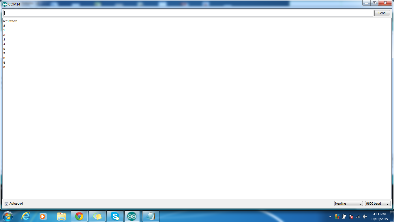

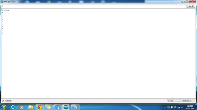

I am trying to interface Arduino Uno with AT24C16 I2C EEPROM IC.I have made necessary connections and have written simple code for writing and reading data from AT24C16. Initially I wrote the data to one random memory location (in my code it is 514) and then read it back immediately after writing. I could read correct data. Then I wrote code for writing to memory locations 0,1,2,3 and 4 in the same sketch. This time also I could read correct data when I read those locations immediately after writing to them. The problem is after carrying out all thees operations, when I wrote the code to read data from, say 2nd location, it is reading the data that is there in 4th location. I got same result when i attempted to read 0th, 1st and 3rd memory locations. But if I ask for 514th location, it returned correct data. So I wrote the code for writing to 515th location and when I read 514th location, it showed the data that is present in 515th location.
I am sending the code that I have tried to write and also the output. I am new to Arduino coding.
Please help me.

I can not confirm your problem. When I run the code you attached, I get the following print out which I think is what you intended.
Written
9
1
2
3
4
5
6
4
9
1
8
