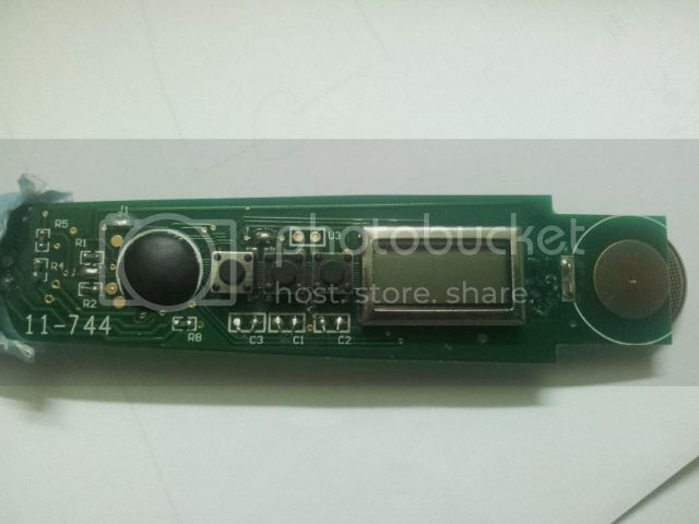

I tried to hack on it in order to get the output readings and interface them to an Arduino board. However, I couldn’t locate the output readings because I faced some problems with this IC which was completely new for me. I couldn’t identify either its model or its number
This are the front and the back pictures of TDS meter after being hacked . However, I couldn't find the output of the IC so can anyone help regarding this issue? and thanks.
So do you guys have any suggestions of what I am supposed to do in order to locate the place of the output and interface it with the Arduino board ?
The output may not be available, you may have to interupt the signals to the lcd to get what you need, then just "push" the buttons with the arduino to get the info
Even if you found which traces the output was on, how would you get that info? And the actual number is in the processor, the only info outside it is the i/o to the lcd
