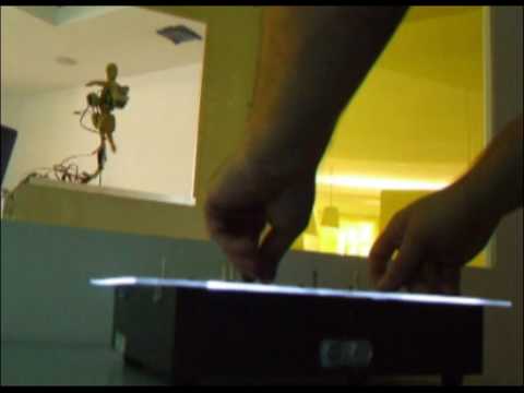

This is what I have achieved with the Arduino MegaServo library, it works good but I want it move smoother and to have more control on the servos movement and speed.
I'm having difficulties making the robot movements smoother and for that I purchased the servo controller. Fow now I just need to know how to connect both the devices.
Very impressive installation!
You can get smoother movements with the MegaServo library if you drive it with microsecond values instead of degrees.

I've been working on this for a while and finally I have the courage to post the results.
I'm also testing the pololu micro serial servo controller in the hope I could achieve better results. One good thing the pololu controller has, is the ability to set the speed of the movement, I guess it is a good plus to have this extra control. And using this feature together with the filter you get really cool and smooth movements, check the end of the video.
The point I don't like in this experience is that the robot shakes a lot, but that is due to the weak support. I will have to arrange a solution to void so much shakiness.
The low pass filter below is what makes the desaceleration while the value reaches the destination point. I've posted the full code below the video.
