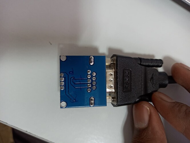

I already extract the data using putty through serial monitor they i have used rs232 to usb interface without setting any handshaking but now i need to extract the data through arduino uno
It (i.e. the hardware handshaking) will be handled within the RS232-USB dongle or putty for you.
But they i didn't set any hardware handshaking and all... The problem is i don't have that manual for weighing scale. What to do now?

If hat still does not work, please upload photos of the top and the bottom of your RS232-TTL module.

It doesn't look like the RS232 module does anything with the handshake lines.
To figure this out I would start with what works (i.e. the PC + putty setup) and try and break it.
If it is a handshaking issue, then the following should confirm it.
Disconnect the RS232 cable from the USB-RS232 adapter. Connect a wire from pin 2 of the cabe to pin 2 of the adapter. Connect another wire from pin 3 to pin 3, and another wire from pin 5 to pin 5.
That should allow just TxData, RxData and Gnd to pass through. If your putty test stops working, then it's likely a handshake issue.
If it is a handshake issue, this can be fixed by putting loopback wires on the handshake pins.

It's not worked while connecting 2 to 2, 3 to 3, and 5 to 5.
but its worked when I connect 1 to 1, 2 to 2, 3 to 3, 4 to 4, 5 to 5. I'm able to see the data in putty
That suggests that the scales are using hardware handshaking. It's probably pin 4. On the RS232 cable connect 4 to 6 (DTR to DSR). You can also connect 7 to 8 (CTS to RTS). That should work but we may also need to do something with pin 1.
i didn't understand what you are saying could explain it in detail
nothing printing in serial monitor
Disconnect your RS232 cable between RS232/TTL converter module and WScale. Put jumpers (Fg-1 of post #33) between WScale and RS232/TTL module and play around with connections until it works.
Yes! Now, you play around. Be sure that each and every jumper (WS to Converter and Converter to UNO) is tested for continuity. Also, try shoring together 7-8l 4-6-1 at the DB-9 connector side of Converter.

Actually my weighing scale had db9 female connector and converter also having db 9 female connector
Then try 2 to 2 and 3 to 3.
Please, give the link to the Technical Manual of the Weighing Scale or its commercial type number.
