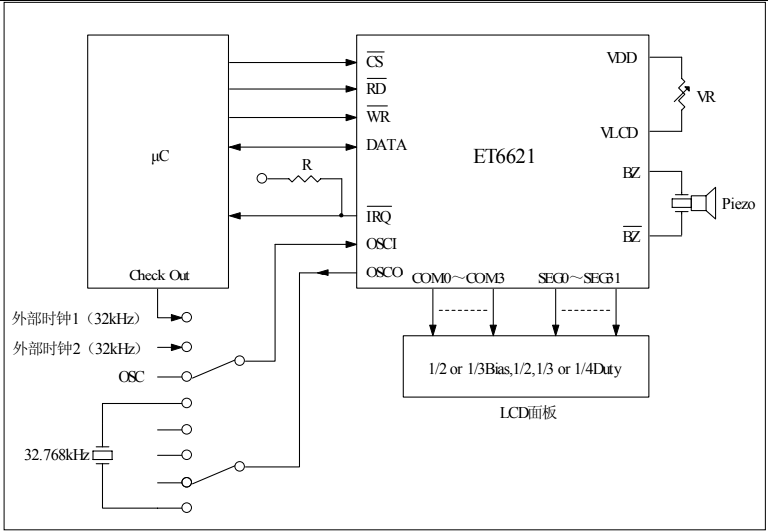

Looks kanji to me. The basic geometry may be 32x4 but as implemented in kanji ...
Start feeding it data and see what it does. The timing diagrams are clear enough.
You're on it's tail. Keep after it! LOL.
(Thinking as i type) ... 32x4 with 5x7 char cell. Thats 6x8 with a cell space between chars 6 char cols x 32 chars x 8 char rows ... 6 x 256 x 4 rows = ~6k bits. No, doesn't seem to to fit 6x17 bits. 17 bits. Four nibbles and a spare bit - it IS shown as nibbles and not bytes on the diagram ... See what else you can worry out of that data sheet ... lemme go look again ...
Pinout shows 32 segments (32 = 2^6!) and four COMx lines. Like four, 32 bit characters.
knknown1
OSCO - Osc Out
OSCI - Osc In
VLCD - LCD Voltage
Vdd/Vss - Vdd/Vss
/CS, /RD, /WR - standard stuff
DATA - I/O so you can read it back out
/IRQ - gotta be an output
BZ/BZ - 2khz/4khz buzzer outputs
  • Starburst display?
The segment addresses are broken down into two groups. 0-7 and 8-31. Perhaps two different modes?

So the six A's are the 32 segment ID's and the COMx's control which digit is being written to.
It has a Watch Dog Timer (I see WDT in the notes, which explains the BZ outputs)
Pretty obviously command structure, D- data, C- command
The 101 at the front of the WRITE waveform you posted matches the ID column for the WRITE command. So the first three bits aren't synch, but are command group.
The Fx numbers are the frequency dividers for the WDT.
And now the block makes more sense.

Ok, I hooked up the wires and ran some code, but couldn't get any segments to activate on the LCD. I just tried a few different data streams. Here's the code for the last one I tried. The data in code variable, formatted to match the timing diagram a little better is 101 000010 0001 0001 0001 1000 1. I'm not sure what to do with the "D" sections.

You might want to try the LCD ON and LCD OFF commands, Those don't need the A parts and are fixed. The X is a padding bit that is ignored but the extra clocks are needed to keep things in sync.
Ok, I think I'm getting somewhere. I wasn't able to get any results from the Write commands you suggested, but I do get something if I enter the LCD ON or LCD OFF commands. Both commands have the same result. It flashes one segment for a moment and you can see the faint image of the rest of the segments. But it only does it if you alternate commands. Doing LCD ON or OFF repeatedly won't have any effect apart from the first time.

I got it! It took me a lot of sending random commands to see what has an effect, and I found that I needed TURN ON, SYS EN, and XTAL32k to get the LCD working. Also, the command for BIAS 1/3 with 4 COMS to get the segments looking right.
I also searched for English datasheets of similar LCD drivers, and I found one that was almost identical, HT1620. That, and some research on how multiplex LCDs work, got me to realize that there are 32 addresses (the six-bit A number) and four coms (four one-bit numbers).
The timing diagram we were looking at was to update multiple addresses in a row. To just alter one, it's the 101+AAAAAA+DDDD.
Then I just started running through write commands in a loop, incrementing by one, to see what has an effect.
The LCD I have uses addresses 24-31 and all four COMs.
So the top of the first digit is address 24, the bottom of the first digit is 25, top of second is 26, etc.
After the address you want to change, you add the four bits telling it which segments in that address to turn on or off.
For example, to turn on two segments in the bottom of the first digit and turn two off:
101 011001 0110
