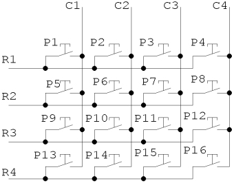

This is the keyboard's circuit diagram, I thought of scanning it like this:
I give power only to R1, I read inputs from C1 to C4, if they are all LOW, I give power only to R2, ...
I was thinking, I should connect C1, C2, C3 and C4 directly to the INPUT pin and with a resistor (and maybe also a diode to prevent the current from another C pin from flowing back to me) to the GND, wouldn't there be a way to connect C1, ... directly to the INPUT pin, without a resistor, without a GND?

No. Input pins without a resistor to GND or Vcc "float", and give random HIGH/LOW readings.

To clarify, this called a keyboard ‘matrix’, and unless specifically called out, almost all known keyboards are ‘scanned’ this way - using x-y columns and rows to minimise the number of i/o pins used.
The key values have no relation to the physical layout until they are ‘mapped’ to specific values by the key scanning routines.
