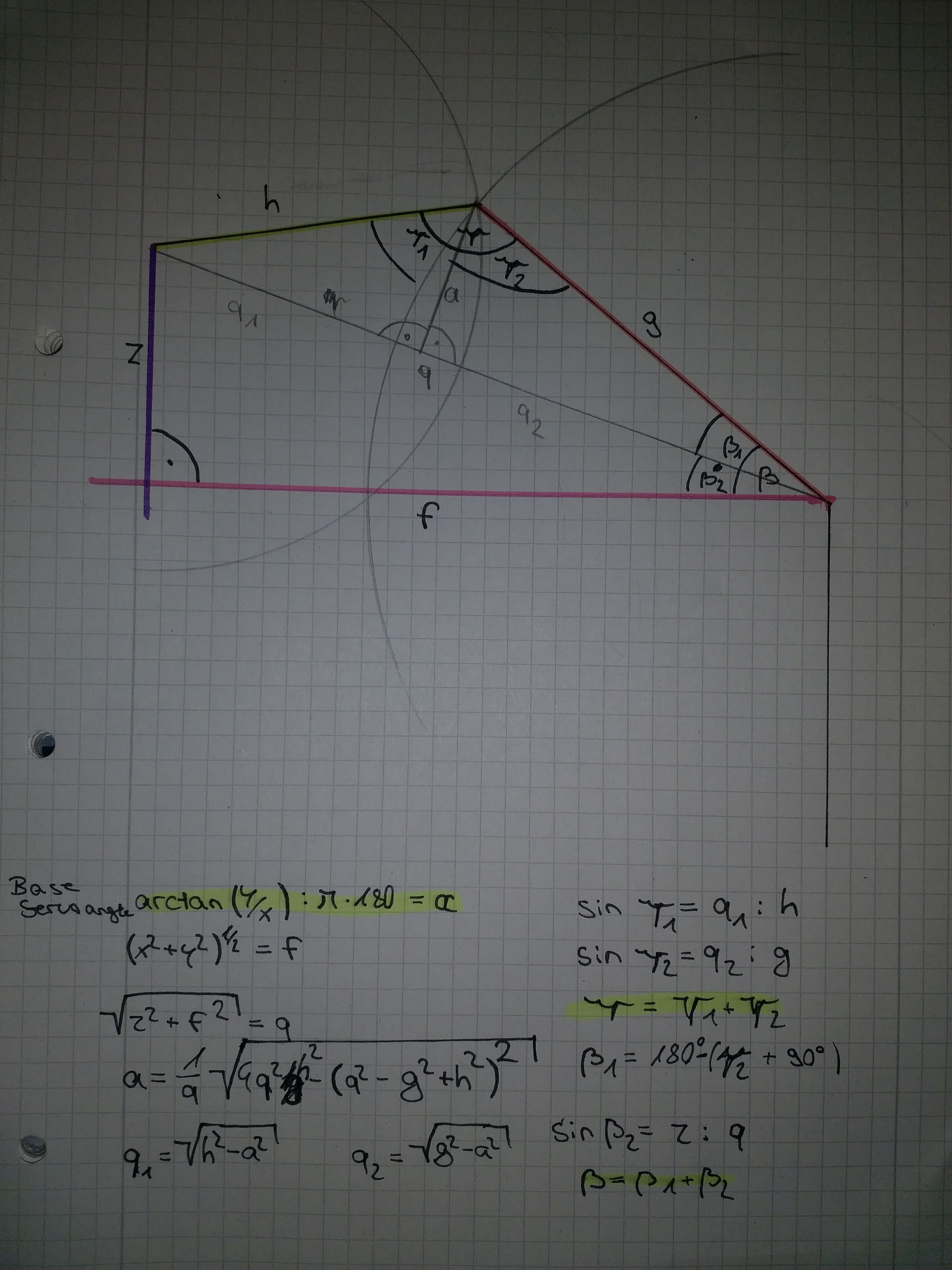

Ok im struggling a bit here what would I do with said Intersection point? And in reference to what would it be?
Ok nevermind I think I have it figured out. I dont have time to program it right now but the math checks out. Thank you so much for your help. Ill be sure to post a picture of my solution shortly.
Here is a picture of my solution.
That's OK. I am throwing around a lot of info. And I may not be describing it well enough.
The circles are on the plane defined by the shaft of the base and the direction of the arm.
The coordinates of the intersection point (blue in the pic above) give us the angle of the shoulder.
Let me drop in a yellow line. Do you see how this lets us define the angle for the shoulder?
Hint, if you know the coordinates of the blue point, you can determine the length of the yellow segment of the opposite side. And you know the length of the red segment since it is the fixed length of your arm piece. That is the Hypotenuse
Sin(angle) = Opposite/Hypotenuse
angle = arcsin(Opposite/Hypotenuse)
Similarly, you can calculate the angle of the elbow. Hint, you will need to take into account the angle of the shoulder since this elbow is attached.
Edit: Oh good! You got it! :smiley:
Edit 2: At least I assume so. You have a lot of good looking notes.
The proof will be when you code it up, build it up and program in some points for it to move the hand to. Good luck and post pics!
Ok I have a Python script but there always seems to be a mathematical erro. Im guessing this is due to me giving it impossible coordinates. do you have any idea on the range of the points the arm could reach mathematically?
Yes. Ones where the number of circle intercept points is greater than zero.
Which can also be represented as:
The distance from the shoulder pivot to the target point is <= the sum of the lengths of the arm pieces
and
The distance from the shoulder pivot to the target point is >= the difference of the lengths of the arm pieces
That is mathematically. Now realistically, there are other constraints.
The target point must not result in a join angle greater than the mechanical limit of rotation for that joint.
The target point cannot be inside the structure of the arm or base.
The target point cannot be below the surface on which the arm rests (unless you have it setting near the edge of a table)
