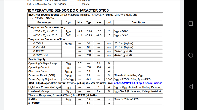

From the MCP9808 data sheet:
The current should be less than 0.5mA when active and less than 1uA in sleep.

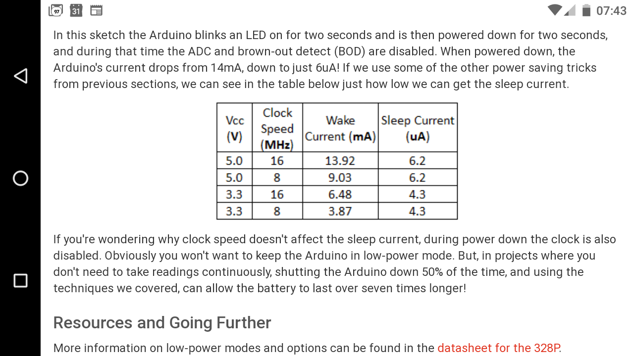

This article shows what can be achieved with Pro Mini 3.3V:
