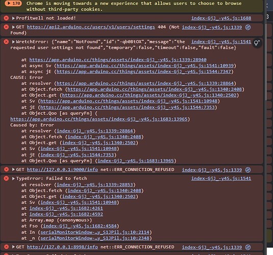

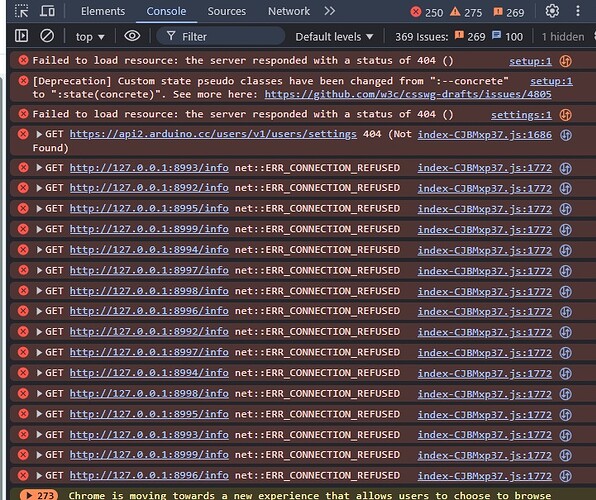

I did one other thing. While the web page for the thing is open at the setup I looked at the developer tool in google chrome. I did the same when I opend the sketch tab. There were a lot of errors. Specifically the error 404.
So I dont know if this can tell you guys something. But I added a picture of what I found there

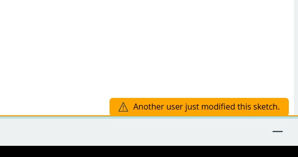

I get an error telling me somebody has been editing my sketch will I'm busy. Like we are working on the same sketch simultaniously. But that is imposaable. I have added a screen shot

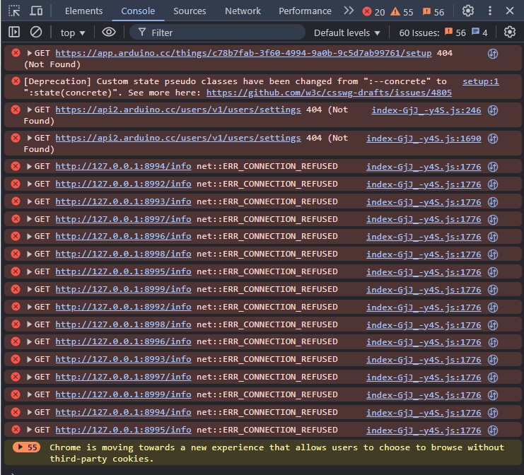

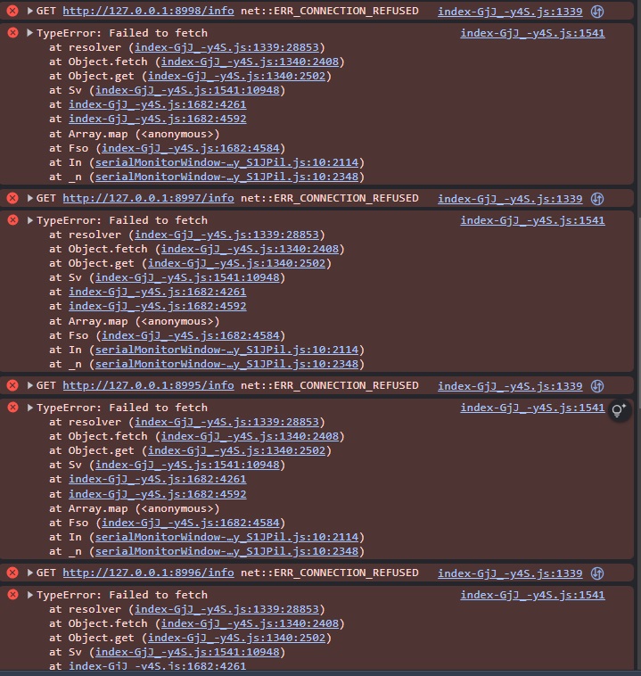

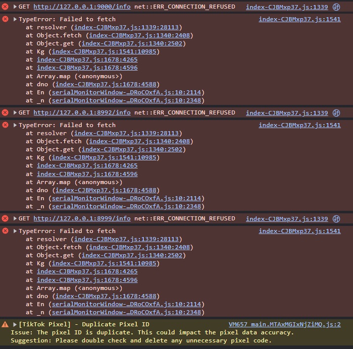

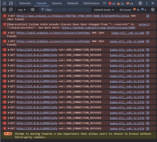

There is still many errors in the developer console. It looks like a war zone. I have added screenshots of that as well.

The error that "another user just modified this sketch" is still present.

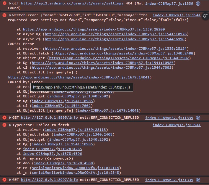

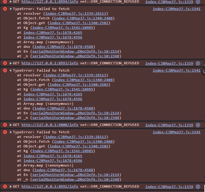

Whe I navigate to my thing and is in the setup. the below is in the developers code. Seems the Error 404 is still there. That cause the ERR_CONNECTION_REFUSED. There are errors in the sketch tab aswell. I added these below as well.

Just to let you know. The "script error" and the "another user just modified this sketch" is still present.

The erros in develop console is still there.
