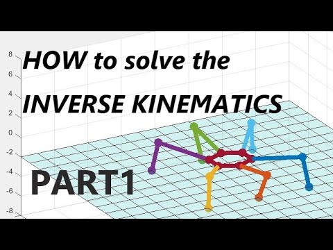

im unable to find out a way to send the foot of the bot to the position its supposed to be
with servo function it is possible since im using i2c im having trouble finding the current loc and making the kinematics eqn for the same

Maybe this could help
IF it is confusing, then you are not putting the movement of each servo into a separate function so you can call that function some number of times to get that motion. When you combine all the primary movement function calls for an appendage and do each function the required number of times, you will get the motion you want.

i think i have managed to solve the code
inverse kinematics helped me...also using multiple functions for each servo.
