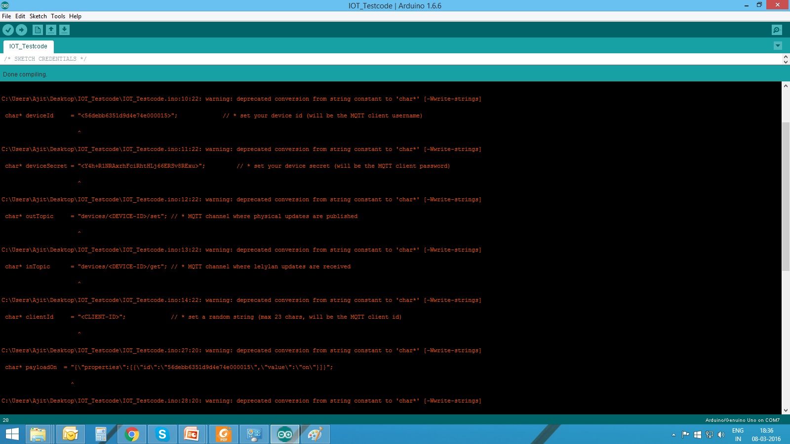

I downloaded the library compiled successfully on arduino 1.6.6
But i get error has below with compile
C:\Users\Ajit\Desktop\IOT_Testcode\IOT_Testcode.ino:10:22: warning: deprecated conversion from string constant to 'char*' [-Wwrite-strings]
char* deviceId = "<56debb6351d9d4e74e000015>"; // * set your device id (will be the MQTT client username)
C:\Users\Ajit\Desktop\IOT_Testcode\IOT_Testcode.ino:11:22: warning: deprecated conversion from string constant to 'char*' [-Wwrite-strings]
char* deviceSecret = "<Y4h+R1NRAxrhFciRhtHLj66ERSv8RExu>"; // * set your device secret (will be the MQTT client password)
C:\Users\Ajit\Desktop\IOT_Testcode\IOT_Testcode.ino:12:22: warning: deprecated conversion from string constant to 'char*' [-Wwrite-strings]
char* outTopic = "devices//set"; // * MQTT channel where physical updates are published
C:\Users\Ajit\Desktop\IOT_Testcode\IOT_Testcode.ino:13:22: warning: deprecated conversion from string constant to 'char*' [-Wwrite-strings]
char* inTopic = "devices//get"; // * MQTT channel where lelylan updates are received
C:\Users\Ajit\Desktop\IOT_Testcode\IOT_Testcode.ino:14:22: warning: deprecated conversion from string constant to 'char*' [-Wwrite-strings]
char* clientId = ""; // * set a random string (max 23 chars, will be the MQTT client id)
C:\Users\Ajit\Desktop\IOT_Testcode\IOT_Testcode.ino:27:20: warning: deprecated conversion from string constant to 'char*' [-Wwrite-strings]
char* payloadOn = "{"properties":[{"id":"518be5a700045e1521000001","value":"on"}]}";
C:\Users\Ajit\Desktop\IOT_Testcode\IOT_Testcode.ino:28:20: warning: deprecated conversion from string constant to 'char*' [-Wwrite-strings]
char* payloadOff = "{"properties":[{"id":"518be5a700045e1521000001","value":"off"}]}";
C:\Users\Ajit\Desktop\IOT_Testcode\IOT_Testcode.ino: In function 'void loop()':
C:\Users\Ajit\Desktop\IOT_Testcode\IOT_Testcode.ino:75:26: warning: deprecated conversion from string constant to 'char*' [-Wwrite-strings]
lelylanPublish("on");
C:\Users\Ajit\Desktop\IOT_Testcode\IOT_Testcode.ino:79:27: warning: deprecated conversion from string constant to 'char*' [-Wwrite-strings]
lelylanPublish("off");
C:\Users\Ajit\Desktop\IOT_Testcode\IOT_Testcode.ino: In function 'void callback(char*, byte*, unsigned int)':
C:\Users\Ajit\Desktop\IOT_Testcode\IOT_Testcode.ino:128:24: warning: deprecated conversion from string constant to 'char*' [-Wwrite-strings]
C:\Users\Ajit\Desktop\IOT_Testcode\IOT_Testcode.ino:132:25: warning: deprecated conversion from string constant to 'char*' [-Wwrite-strings]
Sketch uses 19,892 bytes (61%) of program storage space. Maximum is 32,256 bytes.

For this i have attached login details as below.
I don't see an error.
In that statement, "<56debb6351d9d4e74e000015>" is a string constant. If you are to define the proper variable to hold it, the variable's type would be const char *, not char *.
If the warning bothers you, the line should read:
  const char *deviceId = "<56debb6351d9d4e74e000015>";

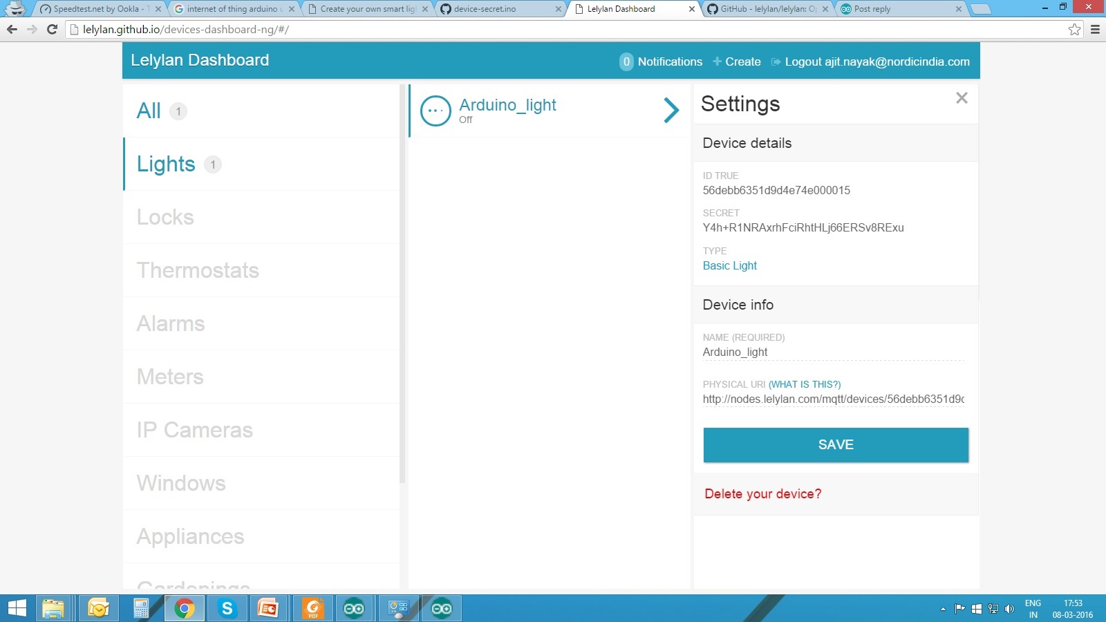

My question How can i Assign
char* deviceId     = "<DEVICE-ID>";      // * set your device id (will be the MQTT client username)
char* deviceSecret = "<DEVICE-SECRET>";  // * set your device secret (will be the MQTT client password)
My ID =56debb6351d9d4e74e000015
secret=Y4h+R1NRAxrhFciRhtHLj66ERSv8RExu
Mentioned that:
Lelylan uses MQTT, a publish subscribe protocol for the Internet of Things. To make Lelylan communicate with Arduino you need to set two topics: one receiving messages from Lelylan (inTopic) and one sending messages to Lelylan (outTopic). These topics are unique and identified by the device id.
char* outTopic = "devices/<DEVICE-ID>/set"; // * MQTT channel where physical updates are published
char* inTopic = "devices/<DEVICE-ID>/get"; // * MQTT channel where lelylan updates are received
I have warning as below in atached image
const char *deviceId = "56debb6351d9d4e74e000015";
const char *outTopic = "devices/56debb6351d9d4e74e000015/set";
char *deviceId     = "D56debb6351d9d4e74e000015";             // * set your device id (will be the MQTT client username)
char *deviceSecret = "Y4h+R1NRAxrhFciRhtHLj66ERSv8RExu";         // * set your device secret (will be the MQTT client password)
char *outTopic     = "devices/<DEVICE-ID>/set"; // * MQTT channel where physical updates are published
char *inTopic      = "devices/<DEVICE-ID>/get"; // * MQTT channel where lelylan updates are received
char *clientId     = "<CLIENT-ID>";             // * set a random string (max 23 chars, will be the MQTT client id)
I have modified as follow you suggested . Still same error coming
AMPS-N:
char *outTopic    = "devices//set"; // * MQTT channel where physical updates are published
char *inTopic      = "devices//get"; // * MQTT channel where lelylan updates are received
char *clientId    = "";            // * set a random string (max 23 chars, will be the MQTT client id)
Same code - same error warning.
No surprise there.
Read PaulS' earlier reply.
Yes the error resolved.

Arduino: 1.6.6 (Windows 8.1), Board: "Arduino/Genuino Uno"
C:\Users\Ajit\Desktop\IOT_Testcode\IOT_Testcode.ino:77:26: warning: deprecated conversion from string constant to 'char*' [-Wwrite-strings]
C:\Users\Ajit\Desktop\IOT_Testcode\IOT_Testcode.ino:81:27: warning: deprecated conversion from string constant to 'char*' [-Wwrite-strings]
IOT_Testcode:124: error: invalid conversion from 'const void*' to 'void*' [-fpermissive]
memcpy(json, payload, length);
In file included from C:\Program Files (x86)\Arduino\hardware\arduino\avr\cores\arduino/Arduino.h:25:0,
from sketch\IOT_Testcode.ino.cpp:1:
c:\program files (x86)\arduino\hardware\tools\avr\avr\include\string.h:117:14: error: initializing argument 1 of 'void* memcpy(void*, const void*, size_t)' [-fpermissive]
extern void *memcpy(void *, const void *, size_t);
IOT_Testcode:125: error: assignment of read-only location '*(json + ((sizetype)length))'
json[length] = '\0';
C:\Users\Ajit\Desktop\IOT_Testcode\IOT_Testcode.ino:130:24: warning: deprecated conversion from string constant to 'char*' [-Wwrite-strings]
C:\Users\Ajit\Desktop\IOT_Testcode\IOT_Testcode.ino:134:25: warning: deprecated conversion from string constant to 'char*' [-Wwrite-strings]
IOT_Testcode:139: error: invalid conversion from 'const void*' to 'void*' [-fpermissive]
free(json);
In file included from C:\Program Files (x86)\Arduino\hardware\arduino\avr\cores\arduino/Arduino.h:23:0,
c:\program files (x86)\arduino\hardware\tools\avr\avr\include\stdlib.h:305:13: error: initializing argument 1 of 'void free(void*)' [-fpermissive]
extern void free(void *__ptr);
exit status 1
This report would have more information with
"Show verbose output during compilation"
enabled in File > Preferences.
You have been told what to do to make the warnings go away. Engage your fingers in the IDE or external text editor for a while, not here.
json[length] = "\0";
IOT_Testcode:125: error: invalid conversion from 'const char*' to 'char' [-fpermissive]
free(json);
exit status 1
I could not able to resolve the warning message. I have changed as per suggestion. Still i am getting these warning.
