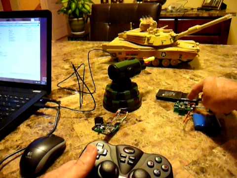

I combined the PSX Analog controller with an nrf24l01 transmitter to control a tank. I uploaded a youtube video: http://youtu.be/MWm9OSi9U6c

I hacked a usb missile launcher. Here is a youtube video: http://youtu.be/kwi1YTnKUTA

Back in September Dan mentioned it would be better if the tank movement was more realistic/proportional. I agreed but was limited by the number of pwm outputs on the atmega168/atmega328. I use up 1 PWM output on my IR transmitter (D3) and more are tied up with the SPI output to my RF component (D8…D13). That only left me D5, and D6 but I needed 4 PWM outputs for Left/Right Forward/Reverse.
To solve this, I placed an additional slave atmega168 on my pcb. The master communicates with the slave via IIC. The slaves sole purpose is to control Left/Right Forward/Reverse. Here is a sample video: http://youtu.be/ph8wXu_7DWQ
