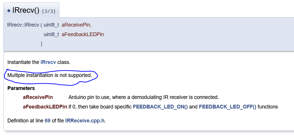

Looking for a good library to watch 2 IR receivers/compare to locate a beacon
I ask on here, because I’ve tried about 5 so far and they all suck to varying degrees,
mostly only allowing 1 receiver
(Most of the trouble has been shrouding everything so it doesn’t just pickup reflections : )

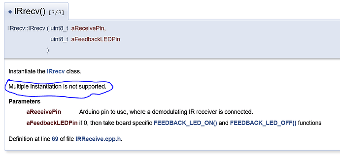

I am exploring https://github.com/Arduino-IRremote/Arduino-IRremote
Can anyone see how to declare more than ONE “IrReceiver.begin” based on this?
Relying only on a carrier wave, the beacons would not be able to be in the same area of influence. You will not be able to tell them apart either.
I think you’re out of luck.
But you’ll probably be able to switch between the receivers pretty quickly.

This is as far as I got for anyone trying to torture themselves.
https://github.com/Neco777/Arduino-IRremote/tree/master/examples/IRrecvMulti
That’s for a variant allowing multiple IR receivers, it needs to have out of date libraries installed, then updated code for 3.0+ from here:
what a clusterfk,
will update when I find a less ret
*ed solution
