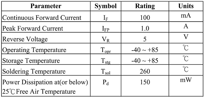

Hardware - Arduino mega 2560 R3, IR 950 nm LED with positive connecting to 100 ohm resistor and then pin 5 of PWM. Short lead to ground. Here is my code and a picture of the remote I have:

You can check if the emitting LED works with your phone's camera - as long as it doesn't have a built-in IR filter. Even working with a 100 ohm resistor seems very large in value to me. Usually IR LEDs have quite a high operating current and you will need to drive it with a transistor because the Arduino pin cannot provide enough current.
https://www.mouser.com/datasheet/2/143/EAILP05RDDB1-708504.pdf
