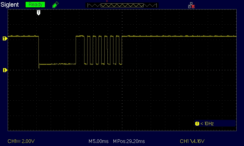

I saw the posts here for the ir sensor module and the 16x2 LCD. I decided to alter it to show the button code on the LCD. My problem was that a remote like my tv remote had a code followed by FFFFFFFF.
Seems that code says the button is still down or ends the code, so I had to alter the code to find the first code a remote send for a button. Here is my code. (Based on on the earlier one posted. Hope this will help someone to understand this cool little sensor. (AX-1838HS).

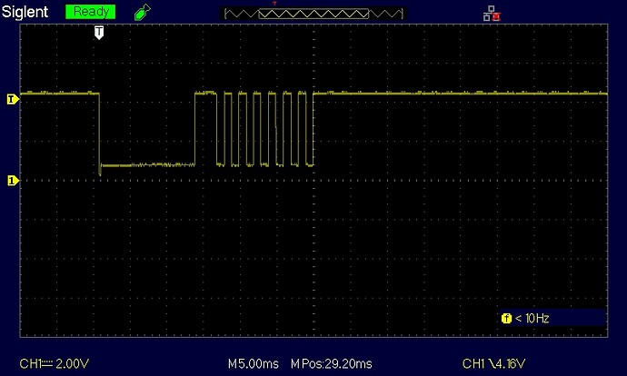

I started looking at the code with a Digital Oscope and Yes I can decode the code from the bits on the scope from the TV remote or my roku remote, but my camera remote has me puzzled. Both my code and the serial monitor says 8DCDAE60 but on the Oscope it doesn't look like 9 bytes of info, so I am confused.
Anyone with idea how that code is from that waveform?
