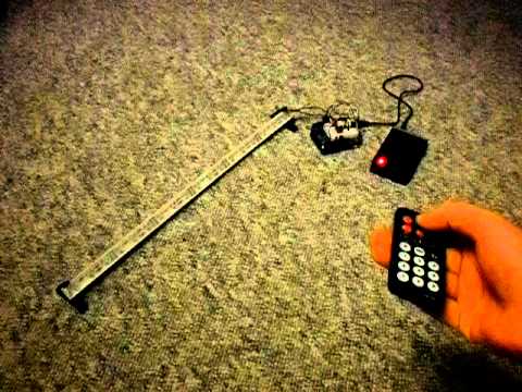

I am working on a project for my parents, where they easily can change the PWM for the R G B channels with a remote.
To read the IR signal, I used the lib. from this site An Arduino universal remote: record and playback IR signals
So far it only turns them on at full power when the arduino is powered up, but later versions should use the EEPROM to store different presets.
When selecting a color with the remote, the selected color will blink fast to indicate which one is selected. Same thing will happen when that color is at full brightness and same for low.

looks great, good work!
