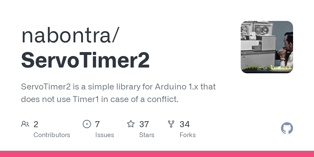

hello I've wrote this code parts of it I've copied and pasted from online sources.
My problem is that when i press the button that ring the buzzer it will ring then it will not accept pressing any more buttons on the IR remote unless i restart the device any suggestions what could be the reason?

These two libraries both use Timer1 hardware and don't work properly together. There is a third-party "ServoTimer2" library that uses Timer2 instead and will work with IRremote.h
thanks I couldn't find the ServoTimer2 in library manager. can you suggest another library and how to get those library commands?
a good opportunity to use @StefanL38 new tutorial:
Use IrReceiver.start() instead of IrReceiver.resume()!
