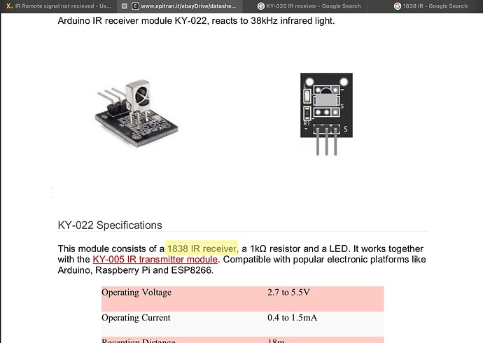

I am trying to getting a signal from a remote via the IR reciever KY_020 to the arduino, but i don't get a signal back to the arduino.

LarryD
January 5, 2023, 7:22pm
2
Always show us a good schematic of your proposed circuit.
Show us a good image of your ‘actual’ wiring.
Give links to components.

LarryD
January 5, 2023, 8:12pm
8
Your sketch here works perfectly.
Try new wires.
We need to confirm the actual IR receiver part number, you could try a new sensor but if it is wired incorrectly, it will get destroyed.
Try a new battery in your remote.
What remote control are you using? Is it 38KHz modulation like the receiver? It likely is but no guarantee.
What protocol is the remote control?
LarryD
January 5, 2023, 9:55pm
10
Huston we might have a problem.
From what we see the receiver is a TSOP1838.
Different footprint than your wiring.
You may have damaged the component.
LarryD
January 5, 2023, 9:58pm
11
Is there a part number on the back of your receiver ?
gonana
January 5, 2023, 10:38pm
12
Sadly not thats why i used the resource from the company i bought it from but apperently the switch a bit.
How do i know if it is broken or not cause it is still not working but i am not sure if it is broken or not
gonana
January 6, 2023, 6:10pm
14
Yeah i have rewired it the right way now but is there a way for me to find out if it did break it or not

gonana
February 2, 2023, 5:57pm
18
I tested everything and then bought a new one the connection from above from @LarryD is right and my code works, I just destroyed the other one
