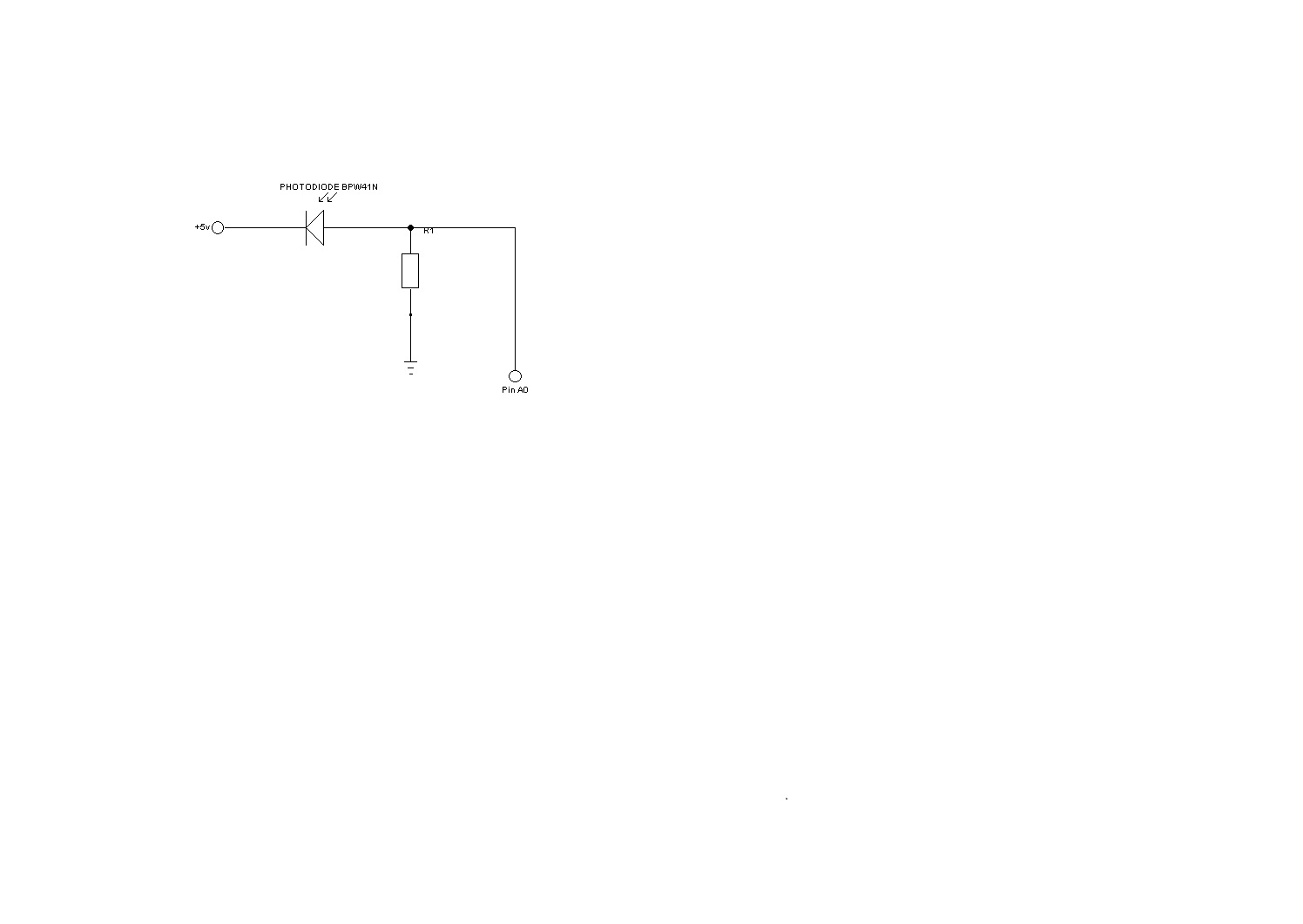

I'm experimenting with a "Beam-Breaker" setup to sense presence of rolling stock on a model railway layout. I'm using a TSUS5400 IR emitter and have paired it with the following sensors, which appear to work equally well
  1. A BPW41 IR diode (2 legs), used the "Right" way around i.e. anode to the + side of the circuit, cathode to the A0 pin (with the resistor to ground, circuit schematic attached).
  2. A L-7113P3C Phototransistor

  1. I've read in several places (but can no longer find the links!) that the IR Photodiode should be connected the "Wrong" way around i.e. with the Cathode to the + side of the circuit (Schematic attached), but I don't see the benefit of this - or even that it would work. Could someone explain please in simple terms? NB I haven't tried it yet in case I've misunderstood, and end up blowing something up!
  2. I'm not sure of the differences/benefits of the IR Photodiode v IR Phototransistor - again is there a simple explanation (in my context)

Photodiodes and phototransistors work on the same basic principle: when light falls on a diode junction, a small current is generated but it flows in the opposite direction of the diode "arrow" symbol. For reliable operation the current from a photodiode generally needs to be amplified before detection by an Arduino, which is done for you by the transistor action of the phototransistor.
Either a photodiode or a phototransistor can be made to work in your situation but you've already noticed the real problem: sensitivity to changes in ambient light levels. You will generally be better off using a phototransistor with matching light source (e.g. IR LED) but in difficult cases you may need to modulate that light source so that it is much more easily distinguished from the background. IR remotes work this way, but modulating the beam (turning it on and off) at a frequency of typically 38 kHz. You can buy modulated photointerruptors for this case.
Update 25/02/2014 - a bit of egg on face here - had another look at the Vishay datasheet and realised that what I'd thought was a top-down drawing of the item was a bottom-up one, so I had connected the cathode to positive after all! In my defence I have to add that the wires are both the same length :blush:
Which means that I'm measuring the current described by JRemington (thankyou J) after all, somehow, and my understanding of how the IR photodiode works has now changed. I'm effectively removing the "block" on current transmission when the IR LED is shining on the sensor, and gradually replacing it as I "Break the Beam", rather than the diode being activated while IR light is shining on it which is how I thought it worked :astonished:.
Am I getting readings on A0 simply because I'm measuring the current being passed from the +5V supply, in addition to the current generated by the Photodiode itself?
Updated schematic attached to this reply, original removed from the original post.
If your most recent diagram is correct (what is the value of the resistor?) then you are measuring the voltage drop across the resistor, due to the photo-induced current in the diode. To check if this assumption is correct, put the assembly in pitch darkness -- you should measure 0 V. Furthermore the voltage should increase linearly with light intensity, but you would need some other way to measure light intensity to verify that.
Readings go down to 1 or 2 when the IR LED is switched off, and 0 when there is no light.
The resistor is 100k. Smaller resistors give smaller readings, larger resistors give larger readings.

I'm getting the results I was looking for, and thanks to JRemingtons info I (nearly!) understand why!
