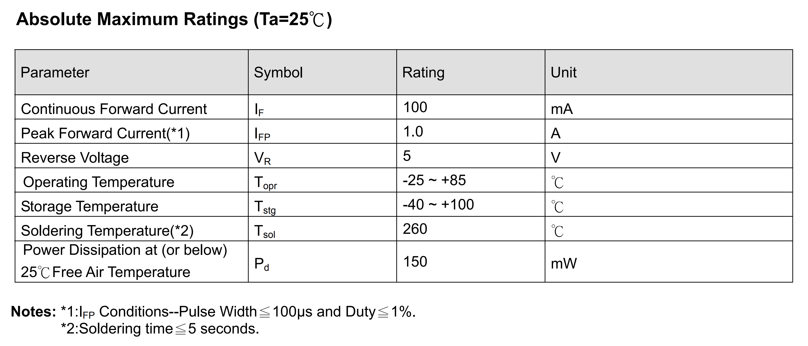

Those are from LAOMAO :
this are the wiring with 220 resistor ( there was not the same IR receiver diode so I put what was closest) :

A resistance of 220 ohms seems high to me. I suggest you try with a much lower resistance, and since the pin of the microcontroller cannot provide a large current, you will have to add a transistor - for example SI2300.
https://www.mouser.com/datasheet/2/143/EAILP05RDDB1-708504.pdf
The typical operating current of such LEDs is 100mA.
Thanks and so which resistance are you suggesting me ? 10 or 100 ? And also the transistors i have are :
NPN S8050 and NPN PN2222 which you would provide me ?
