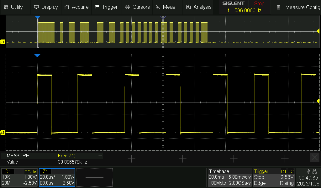

I don't have an Arduino Nano available, but I have tested your code on an Arduino Uno R3 which uses the same ATmega328P.
I can confirm that the code does not produce a 56kHz frequency.
Here is an oscilloscope trace, showing the output from pin 3.
The lower trace is the first part of the upper trace zoomed in (20µs per division).
The frequency measured is 38.9kHz. I've seen it vary between about 33kHz and 39kHz.
To check whether the problem is due to the ATmega328P, I repeated the test on an Uno R4 Minima, a Mega2560 and a Nano ESP32.
All of them gave similar results.

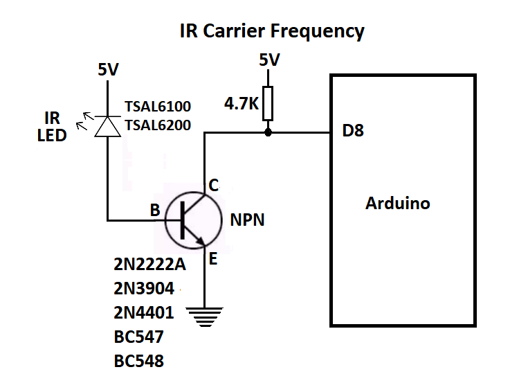

By the way, if you have another Nano or similar, you can detect the transmitted carrier frequency without a scope. You would power the original TXNano from the second RXNano (5V and ground), and connect the output pin of the TXNano to D8 of the RXNano, and connect the RXNano to your computer's USB. The RXNano would run this code to produce output on the Serial Monitor.

If you have an extra IRLED, you can use it to detect the carrier optically from the the TXNano's IRLED output without having to connect the two Nanos. Normally you would use an IR photodiode to detect IR, but an IRLED can also function as a detector, although with much lower effeciency. You would use this circuit:

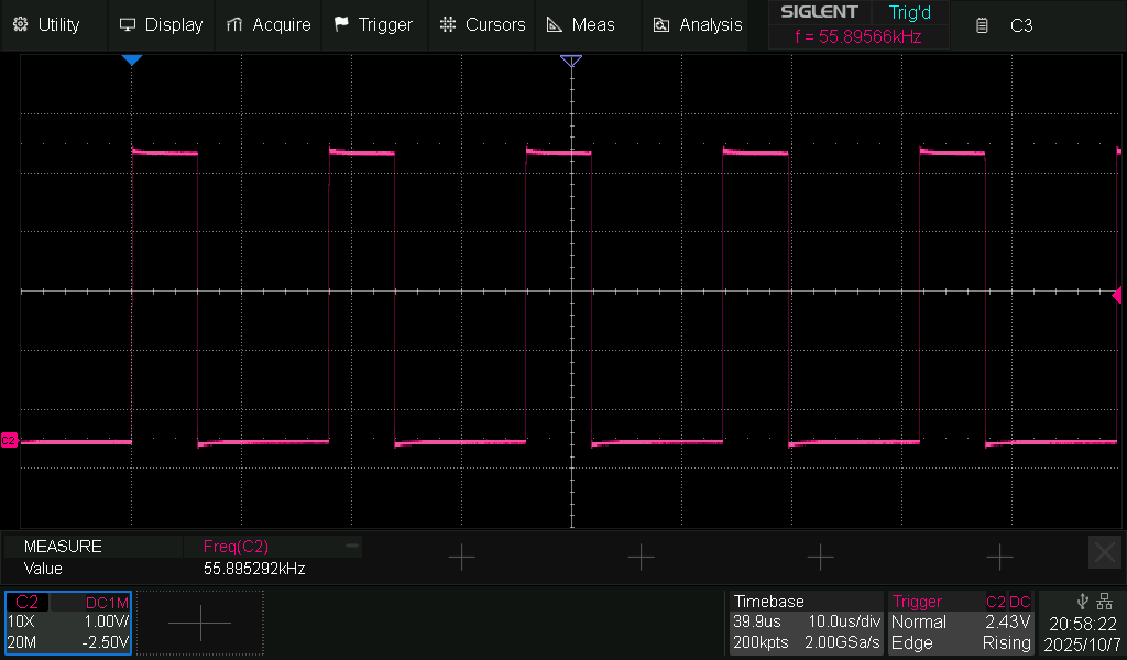

I haven't managed to find the simple and easy solution to the issue.
However I have come up with a work around.
Using 16 bit Timer1 it is possible to generate a continuous 56kHz signal on pin 10.
See gammon.com.au/timers for details.
Code for 56kHz on pin10.
const byte _56kHzPin = 10;
  pinMode (_56kHzPin, OUTPUT);
  TCCR1A = bit (WGM10) | bit (WGM11) | bit (COM1B1);
  TCCR1B = bit (WGM12) | bit (WGM13) | bit (CS10);
  OCR1A =  285;
  OCR1B = 94;

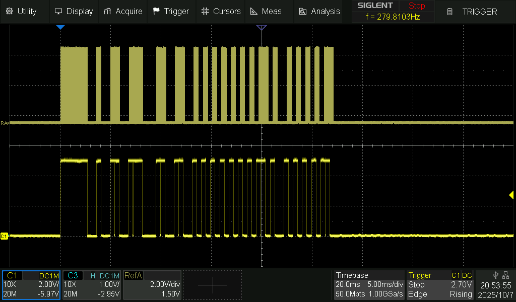

The upper trace is a saved output of the code from post #1.
The lower trace is the unmodulated output of pin 3
The following code will generate a 56kHz signal on pin 10 and the unmodulated signal on pin3.

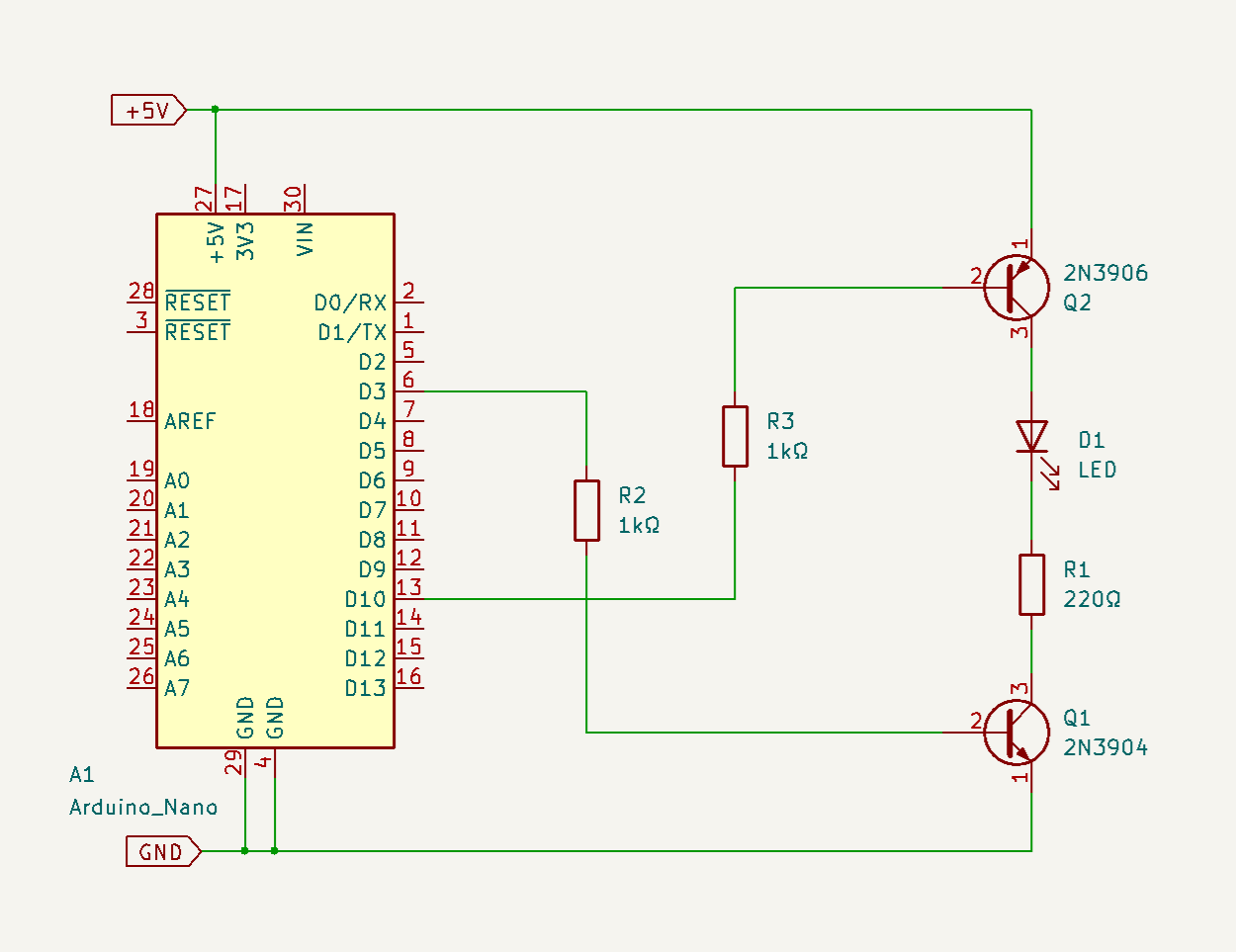

You could then drive an IR LED by applying the 56kHz to a pnp transistor(or P channel MOSFET), and applying the pin 3 signal to an npn transistor(or N channel MOSFET).
See schematic below:
I've tested @ShermanP's code from post #17 using the continuous 56kHz output from pin 10.
It works well:
