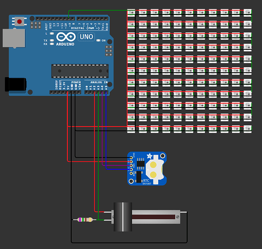

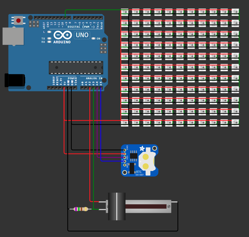

The scaled down information is now here
Schematics:
Relevant code.

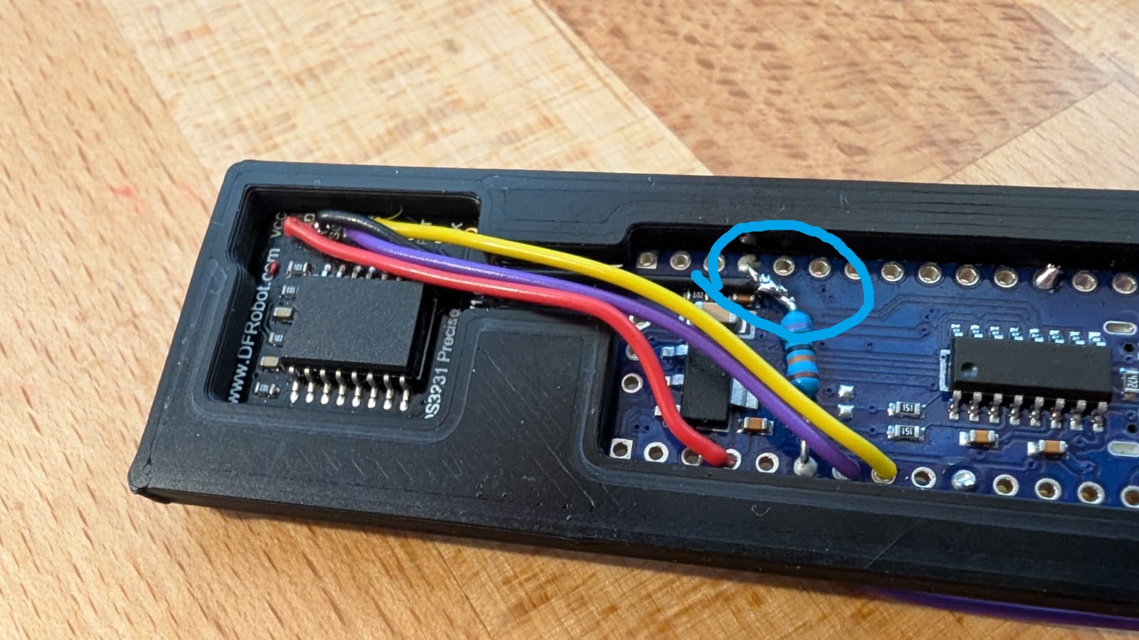

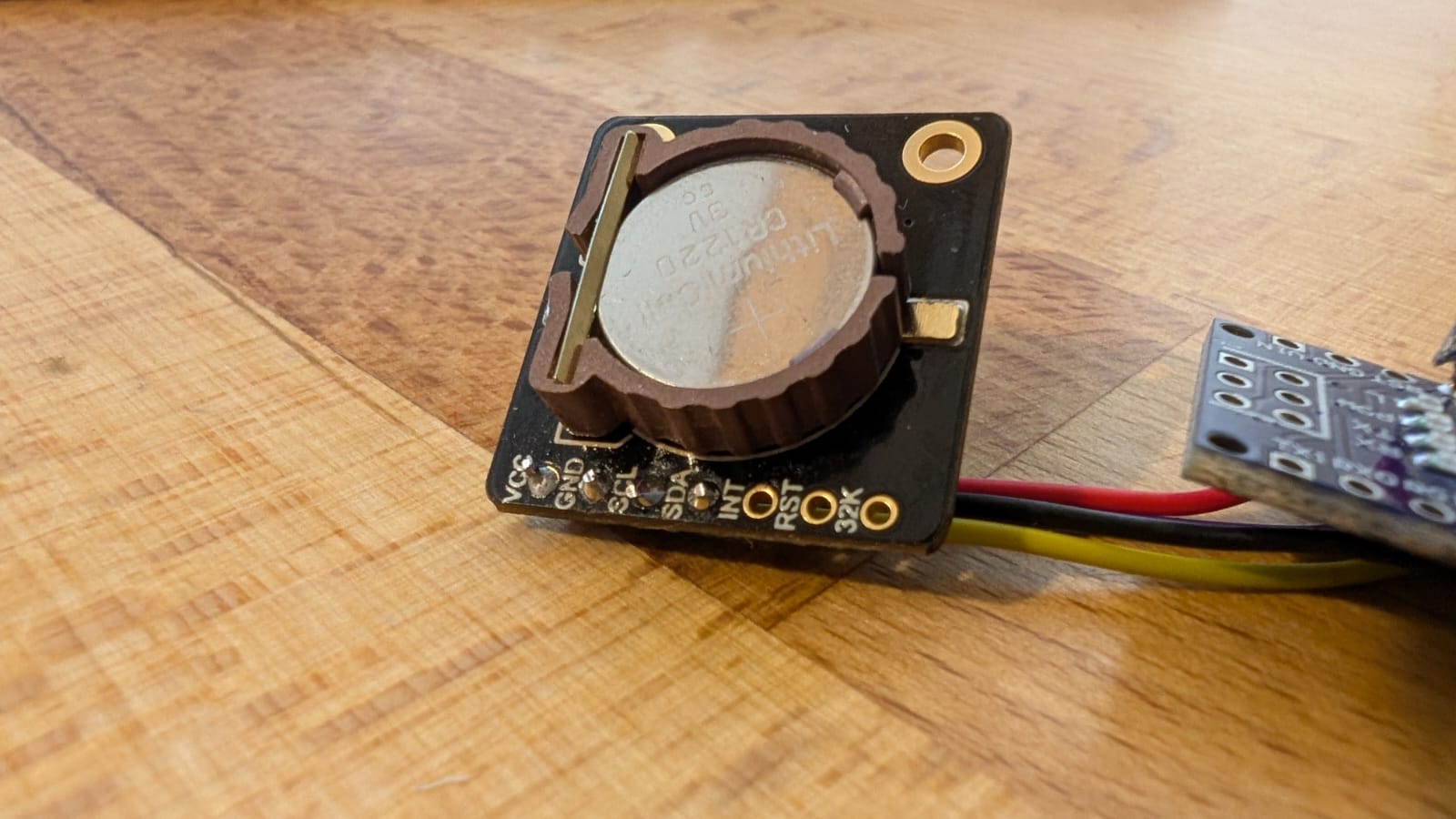

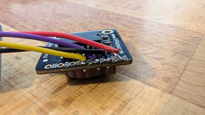

Sorry, I don’t follow links. Please post your annotated schematic here, clearly showing exactly how you have wired the setup. Be sure to include all connections, hardware components, power sources, and any other relevant details. Since soldering damage is a possibility, please also share some clear, close-up pictures of the affected area. Ensure the images are detailed enough to allow for proper evaluation.
Added after it was closed: Your soldering is close, just leave your iron on the joint a bit longer until the solder flows like water. Overall it looks good and thanks for letting us know you found the problem.

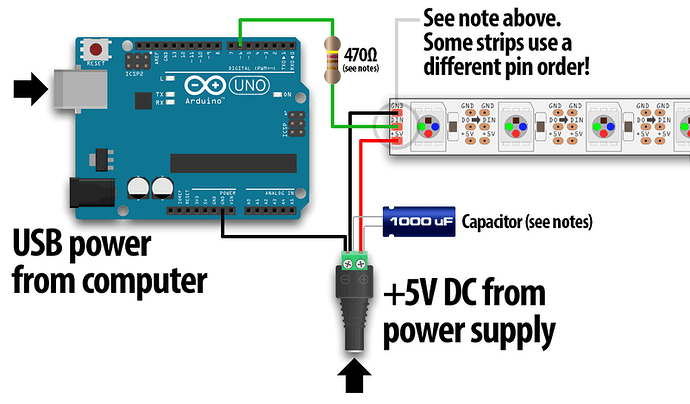

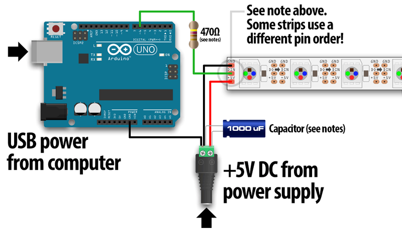

  • Too many pixels for your Arduino to power.
  • Use similar to this circuit.
  • Your slider potentiometer has no +5 power going to it, maybe you meant to have the A2 wire going to 5V ? :thinking:
Hey gilshultz
Thank you for asking for some detailed Pictures. Clipping the Nano and the RCT out of the bracket revealed that the ground connection of the RTC (to the leg of the resistor) was a cold solder joint! :cold_face:
The setup is working properly now :ok_hand:
There is no phototransistor in wokiwi. The resistor forms a voltage divider with the phototransistor - that part works flawlessly :wink:
Also, I don't power the Leds from the Arduino pin. The 5V pin on the Nano is on the same rail as the 5v coming from USB.
As mentioned on the answer to gilshultz, the problem was a cold solder joint on the ground pin of the RTC :v:
