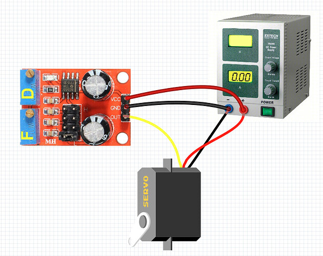

Is it possible to control servo motor with this? If not, please explain why
What is it?
555 timer ic based pwm generator module
i've been trying to use it for the servo but it doesn't works? and my teacher doesn't allows to use anything else than this. you think its. Do you think its suitable for servo
That would likely depend on the values of the components used as they determine the timing of the pulses. You need a way of determining the PWM frequency etc.

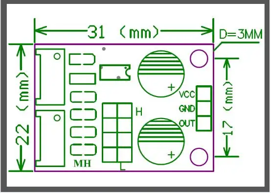

Have you got any data or circuit diagram of that LM555 board?
Found this;
Description
Report Item
Performance:
1. Input Voltage: 5V-15VDC**. when power supply is 5V , the output current can be 15MA around;when 12V power supply, the output current can 35MA around;**
**2.**Input current: >=100MA;
3.Output amplitude: 4.2V V-PP to 11.4V V-PP. (Different input voltage, the output amplitude will be different)
4.Maximum output current: >=15MA(5V power supply, V-PP greater than 50%),>=35MA(12V power supply, V-PP greater than 50%)
4.Output with LED indication(low level ,LED will on; high level,LED will off;low frequency, the LED flashes);
5.The output requency range is selectable:
LF file: 1Hz ~ 50Hz IF file: 50Hz ~ 1kHz
High-frequency file: 1KHz ~ 10kHz
HF file: 10kHz ~ 200kHz
5.Cycle T=0.7 (RA+2RB) C(RA, RB for 0-10K adjustable);
Low frequency:C=100UF;Intermediate frequency:C=1UF;
M-Hfrequency:C=0.1UF;High frequency:C=0.001UF,
Note:
Before changing the frequency, please power off
Application:
**1. Used as****a square wave signal generator,**offer thesquare wave signal for the use of the experimental development.
2. Used to producedriving stepper motor drives, offer thesquare wave signal.
3.Adjustable pulse for the use of MCU.
4. Generate adjustable pulsecontrol circuit.
Parameters:
Product name: NE555 pulse module
Product size: 31.0 mm * 31.0 mm * 15.0 mm (l x w x h)
Colours:RedPackage Weight::7.52g/pcs
Materials: FR4 + electronic components
Sizechart:
Does you teacher understand that this has to be setup frequency and duty cycle to work for a servo?
What level of school are you in?
What subject is this for?
@mactonight

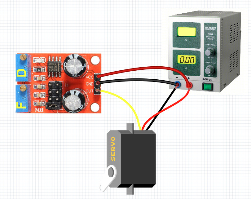

Connect like this:
Put jumper on 1-27Hz position
Turn frequency pot all the way clockwise (CW)
Turn the duty cycle pot to move the servo
