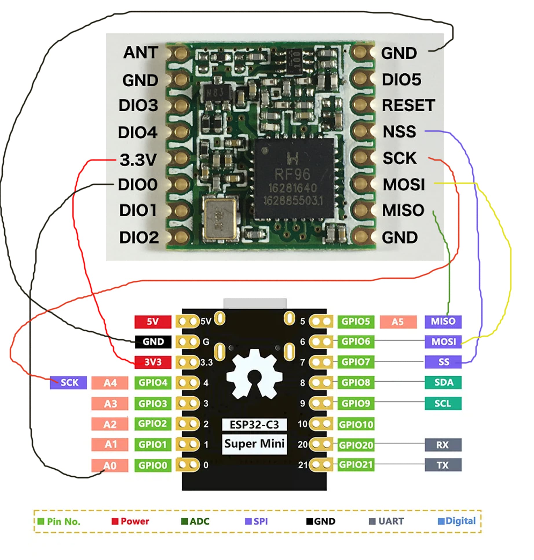

Update: Both devices magically came back online with sample code below. I have no idea why or how. What gives? With that said I still have a question: how's my wiring look?
Question: Are these devices wired correctly in your opinion/estimation? TIA

My Wiring:
My Device:
My Code:

The Problem - No serial output. No LoRa communication. No nothing.
The above code results in no serial output for either device although the power light comes on.
- Checked all connections/continuity between each board - (seemingly) all good.
- Uploaded other simple scripts (I.E. blink leds) without LoRa - works on each device without issue.
- Changed various settings such as the baud rate, different ports on my computer, etc.
- USB CDC on Boot is enabled
Everything was working fine until my computer to which one of the devices was connected went into hibernation mode. When I rebooted each device this morning that's when everything seemed to brick or stall out (no serial output and no confirmation packet sent blinking). At this point the only common denominator is my usb cable although things seem to be uploading without errors/issue and other scripts upload/work fine when LoRa is not incorporated/used. I’m at a loss for what to try or do next and any advice or direction would be appreciated.
