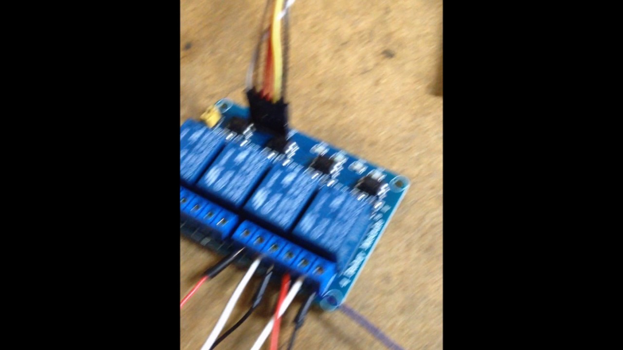

Is my wiring diagram correct to have nano run garage door lock via zwave switch
UPDATE: 7/20/2017
Well, I built the Garage door lock I was trying to make with the Arduino. I did notice I had some errors with the wiring diagram originally attached. I had the 5v- ground going to the ZFM-80 and the Limit switch, and not the 5v+. Also, I needed a pull-down 10k resistor from pin 2 to ground to take care of the debouncing. Everything is working perfectly so far, to my surprise. I have never worked with tiny electronics like these or microprocessors and only understand half of what I read. But this came out better than expected!! I'm extremely happy. I replaced the old incorrect wiring diagram with the New Correct one in case this helps anyone in the future. I've also attached the code I used to Program the Nano, and will attach a video on the Next post.
-Original Post-
Hello Arduino word, I just discovered the Arduino 3 days ago after watching a YouTube video and discovered it might be exactly what I'm looking for. Im building a zwave Garage door lock to be controlled via smartthings. I have yet to figure out how to program the Nano. I will worry about that later. Right now I'm focused on getting the wiring correct. Attached is what I have so far.
Here's the breakdown.
The nano will be triggered by a ZFM-80 momentary relay switch. The relay switch is powered by 110-120v house power which activates a secondary switch that runs the nano's ground to send a single to the nano.
The nano will then be connected to a 4 relay module (only 3 of the 4 are needed for my project). 2 of the relays will be used to control the polarity of the power being supplied to the actuator. The third will be used to provide power to the garage door motor only when the limit switch is activated (signaling that the lock is disengaged).
I have 1 - 12v/3a power supply that will power the actuator. The same power supply will also split off a separate line of power to be ran through a 5v/3a buck converter that will power the nano (and thus power the relays, limit switch signal, and ZFM-80 signal as well).
I'm not an electrician, and I'm sure I'm missing many things on my diagram. If some one can take a look at the attached file and advise me where I can correct or improve my layout I would greatly appreciate it.
Please Google "electronic schematic". Those are not schematics.
Paul
Ah, sorry. I'm very much new to this. I've corrected the title and language to reflect I'm requesting review of my wiring diagram and not a schematic. Thanks.
Here's the Code I used on the Arduino Nano. The ZFM-80 Zwave relay is not Momentary, but I have set up the code to respond to the ZFM-80 being activated as if it was a Momentary switch by comparing the current state of the Switch on every loop. The ZFM-80 switch has a little led that lights up when its on, which I like. I will be using this led to give me the status of the lock when I enter the garage. On = Garage Door Locked, Off = Garage Door UnLocked.
Note: The Code does not include any programing for Limit Switch just yet. The Limit switch has not arrived in the mail yet, so I'm unable to test it's set up.

Here's the Video of the Lock working. Please let me know if I'm doing something wrong. Thanks :).
