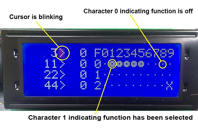

I am working on a project which was originally written for a 2004 LCD, unfortunately, this display is too big for my purposes and as I have a couple of non branded 128 * 64 IC2 SSD1306 displays at hand, I am trying to convert the sketch to use an OLED.

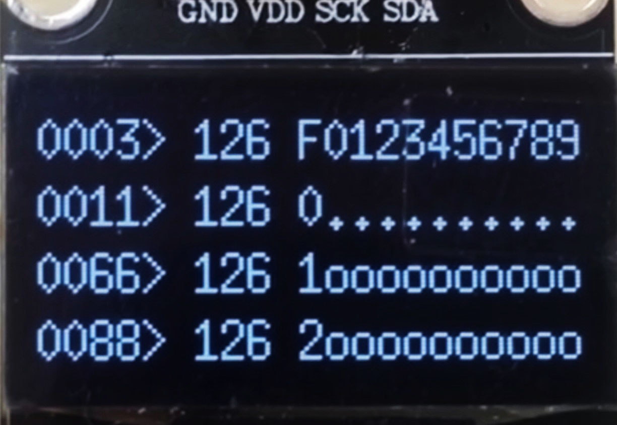

Hardware: Nano V3 clone, 4 x 4 matrix keyboard , rotary encoder and non branded 128*64 SSD1306 IC2 display. All hardware & wiring is correct and functional.
I found out through trial and error that my display is not 100% compatible with the Adafruit library, but that u8g2 works well.
I have the display configured using:
U8G2_SSD1306_128X64_NONAME_1_HW_I2C u8g2(U8G2_R0, /* reset=*/ U8X8_PIN_NONE);
I am trying to work through the sketch 1 line at a time, having commented out all references to lcd so that the sketch will compile and run and so that I can test the results.
I have used "// To be modified for u8g2 library //" to denote what still needs to be done
So far I can only get the display to print simple text and a variables, but I am stumped now and don't seem able to proceed.

uint8_t zerodot[8] = {0x0, 0x0, 0x0, 0x4, 0x0, 0x0, 0x0};
uint8_t onedot[8] = {0x0, 0xe, 0x1f, 0x1b, 0x1f, 0xe, 0x0};
lcd.createChar(0, zerodot);
lcd.createChar(1, onedot);
I can see that these lines generates a graphic image on the lcd, the first a simple dot, the second similar to a donut. They are used to denote if a function option has been selected or not.
and:
lcd.setCursor(4, ActiveAddress);
  lcd.blink();
This positions a cursor and blinks it. I have tried (to the best of my understanding) to follow a couple of examples found online, but I am stumped now.

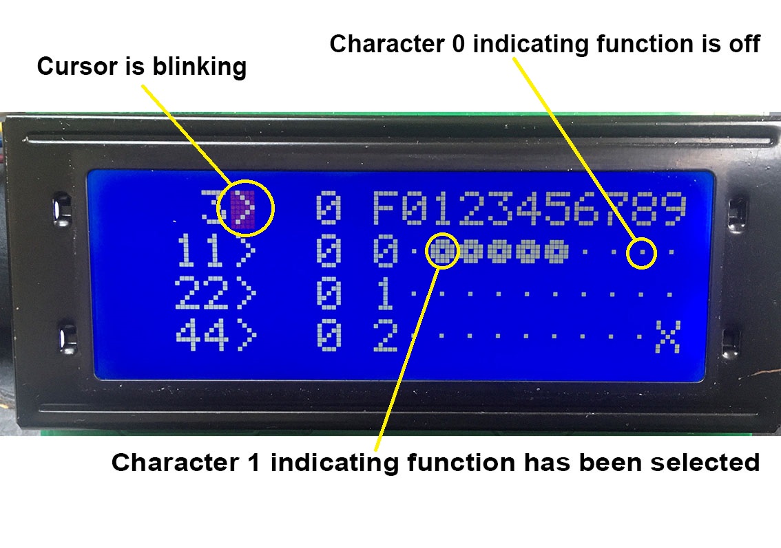

They say a picture paints a thousand words! well 2 pictures must be better! This is what I am trying to achieve. The LCD shows a functioning controller whilst the OLED is just a mock-up. The font chosen for the OLED is no way set in stone, I just wanted to make sure it was legible and all characters could be accommodated.
That looks pretty good. I would just find a sensible alternative for both the circle/dot icons; the way you've done it now can work indeed. And for the blinking you could also find an alternative that does not necessarily have to be animated; you could replace that one '>' with another character that denotes it's 'active'/selected. The main thing is that you understand it, right?
You can create a custom graphics symbol for the OLED display, or even modify the font to replace one of the preexisting characters with your own. The U8g2 github page has all the original font files and the programs needed to re-encode custom fonts into the format used by u8g2.

This font has some characters you could use to replace your dot0 and dot1:

  u8g2.begin();
  /* used to test font suitability for screen, will not be in operational programme
     suitable font:  u8g2_font_6x10_tf
  u8g2.setFont(u8g2_font_6x10_tf);
  u8g2.firstPage();
  do {
    u8g2.setCursor(0, 15);
    u8g2.print("0003> 126 F0123456789"); // Test text to prove text will fit on display
    u8g2.setCursor(0, 30); // Test text to prove text will fit on display
    u8g2.print("0011> 126 0-*-*-*-*-*"); // Test text to prove text will fit on display
    u8g2.setCursor(0, 45); // Test text to prove text will fit on display
    u8g2.print("0066> 126 1*-*-*-*-*-"); // Test text to prove text will fit on display
    u8g2.setCursor(0, 60); // Test text to prove text will fit on display
    u8g2.print("0088> 126 2--***---**"); // Test text to prove text will fit on display
  } while ( u8g2.nextPage() );
  delay(10000);
  u8g2.clearDisplay();
  /* above to be removed
  // Welcome screen
  u8g2.firstPage();
  do {
    u8g2.setCursor(40, 35);
    u8g2.print(("Welcome"));
  delay(2000);
  Serial.println("Oled print Welcome ");

If your program works 100% for a 20x4 LCD display, just buy a smaller COG (Chip on Glass) display.
If you seriously want to use a 0.96 inch OLED it is VERY small.
Seriously, you can port any "Character LCD " program to a "Graphics LCD" program fairly easily.
All Graphics libraries can move a cursor and print text.
All Graphics libraries can "invent" some custom characters.
If you want help, post the original working 20x4 program.
Then readers can show how to adapt for a 128x64 or even a 128x32 graphics display.
Don't worry about memory. You just put text into PROGMEM memory. Which means you have plenty enough SRAM for a full 128x64 buffer. e.g. lcd.print(F("anonymous string"));
Oh, U8g2 is excellent for fancy fonts etc. And paged buffers.
But you will probably find Adafruit_SSD1306 a lot easier to use.
David.
