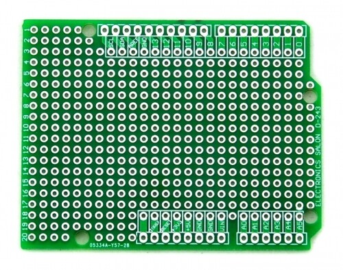

I'm actually using boards similar to :-
so there's no ICSP. They're bare.

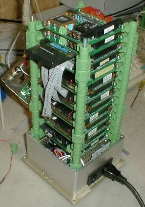

Pins are 2.54mm apart, and slow. Only the Ethernet is fast and that speed only travels from the Uno to the Ethernet shield (directly above it). NeoPixels are fast too but good out to >1000mm. I got my inspiration from PC/104 architecture than runs in the many MHz. These stack quite high:-

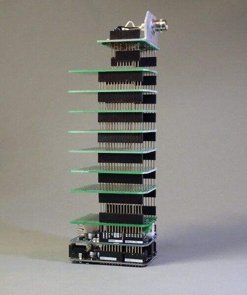

I have 10 shields stacked in front of me, and other than being wobbly (not yet soldered), seem okayish. The highest pin resistance I can measure (relatively) from top to bottom is 0.2 Ohms. Dare I suggest it's sounding good ::slight_smile: ?
That stacking kit you’re using looks good... even impressive !
‘okayish’ isn’t a word I like to use when building permanent projects, but what you have is probably as good as it gets for a lash-up !
As you note, having the fastest boards closest to the Arduino ‘might’ help, but the busses aren’t balanced or terminated, so any noise, ringing or capacitance as the lines get longer, are going to be there regardless.

What I said was sometimes the holes don't align with the ICSP cluster. In your case, they do, thereby allowing you to use the cluster in the normal manner - if you need to. The problem is not the pin spacing, it is the alignment of the entire proto area relative to the headers. If the main patch looks kosher enough but is less than fourteen holes wide, it is time to get cautious.

The shield stack will be a collection of up to seven different types of entropy source. I can build each one at a time and stack them atop the Arduino & Ethernet shield to put them on-line. It’s going to be like an entropy source sampler:-
