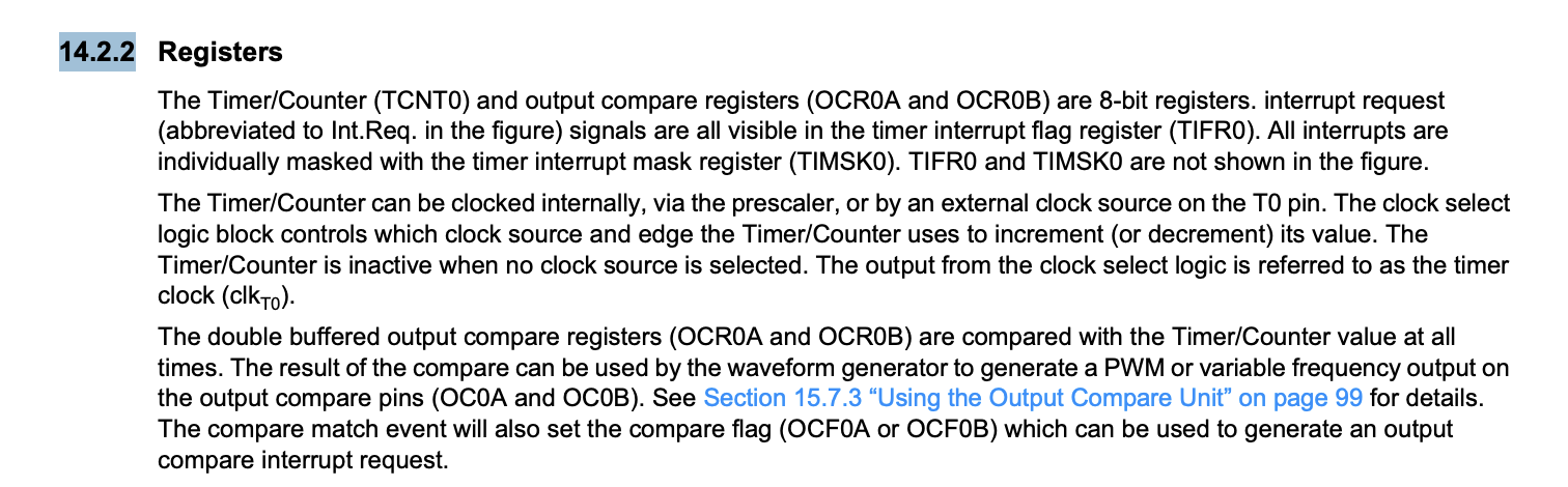

Also, although Atmel didn't explicitly tie the PWM functionality to TIMSK0 in figures nor in register descriptions (as far as I've been able to grasp!), they did 'hint' the possibility of this register playing a role in PWM functionality in 14.2.2:
And then there are also TIFR0 bits that may also partake as you well noted in section 14.9.7 and as also hinted in 14.2.2 as shown in paragraph above.
I guess at this point in history, only the Atmel ATMega328p architects would be able to shed light on this? :man_shrugging:t2:
