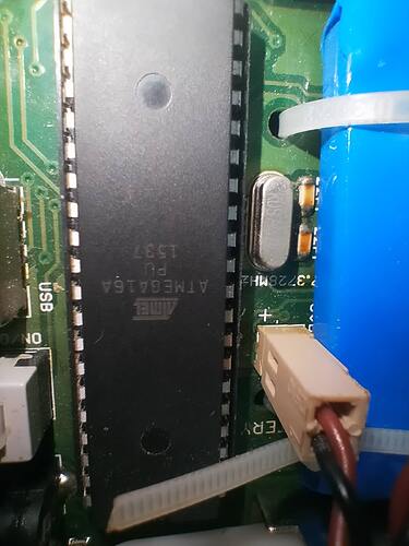

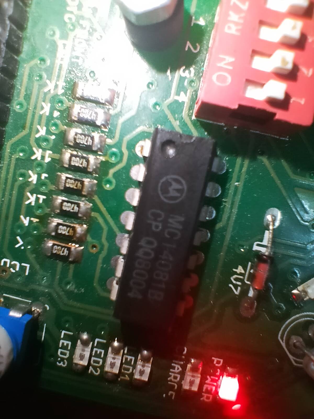

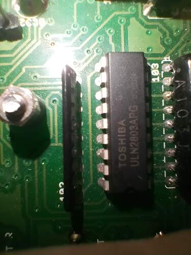

Here are photos of all the 3 chips I can see on the board of the bot:

One thing you can do is take the ATMega16 out of the robot and wire the Uno to the socket (if you have leads).
Trying to program the ATMega16 using the IDE might be possible; there are however a number of dependencies that will determine what is possible (outside my area of expertise).

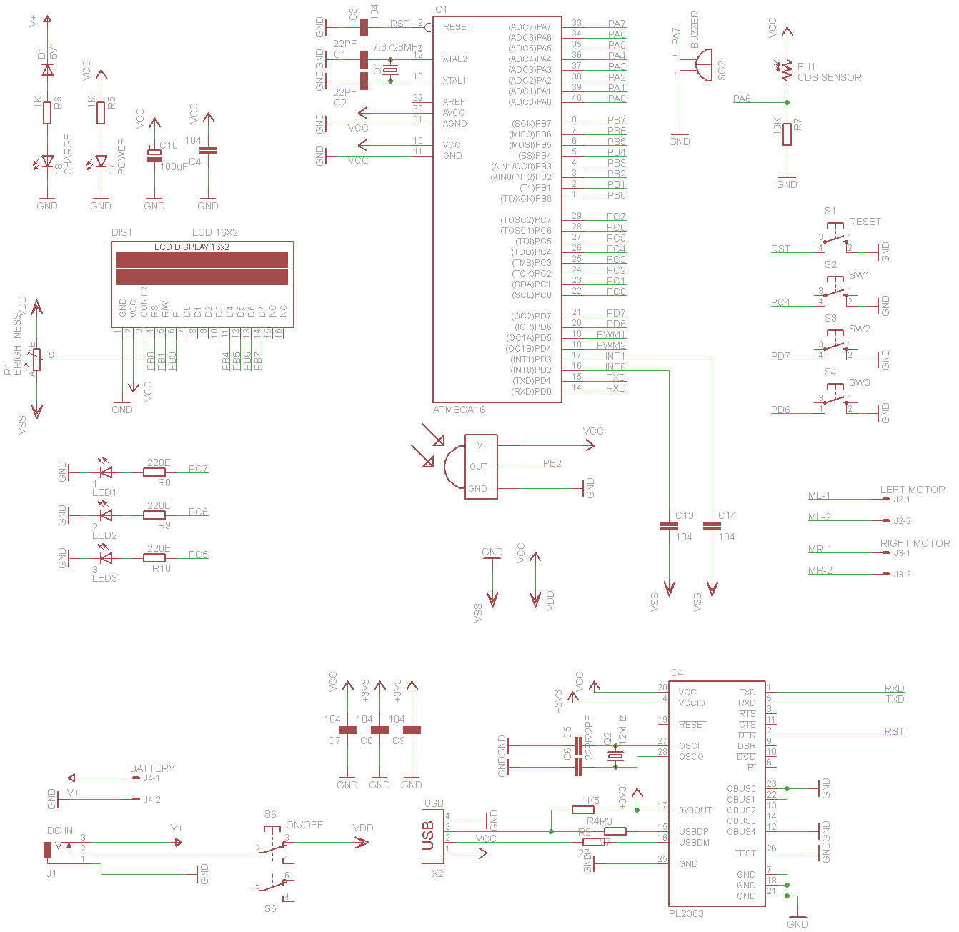

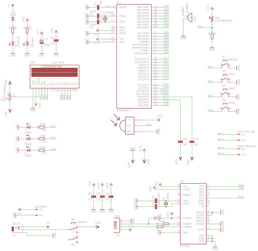

Below the schematic of the board (basics); as indicated in the notes in the zip, some parts are proprietary and not in the schematic
Looking at the schematic of that robot it seems very simular to an arduino with some peripherals.

Going by the diagram posted by sterretje, it looks like the robot is (probably) programmed the same way as the arduino. That is, the robot has a USB to serial converter on board (the part PL2303) which connects the host computer to the serial ports on the ATMega16. Notice the RXD, TXD and RST terminals on the PL2303? They go to the corresponding terminals on the ATMega16. Presumably the ATMega16 has a bootloader pre-installed.
When you upload a program, the PL2303 uses the RST line to reset the ATMega16. Whenever the ATMega16 starts up, the bootloader runs before the user's code. The bootloader checks the serial port to see if a new program is being sent to it. If not, it runs whatever code the user has already installed, if any. If it does detect a new program being sent to it on the serial port, it will write it to program memory. The PL2303 will then send another reset signal. The bootloader will run again, but this time it will not have anything to write to memory and the ATMega16 will run the code you just uploaded.
