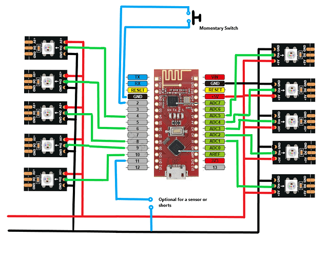

That doesn't help you much because switches should connect between an input and ground,
For switches close to the Arduino itself, you can use INPUT_PULLUP instead of providing a pullup resistor, but that only applies to the digital pins.
A6 and A7 are indeed, analog input only pins and do not have an output function so unlike A0 to A5 which are digital pins, you cannot use INPUT_PULLUP on them and you can also only use analogRead, not digitalRead, so you would need to add a pullup resistor.

Pull the pin* to 5V with a pull-up resistor, and then the switch to ground will make the pin low when the switch is closed. (So you look for low to mean closed.) The pull-up resistor can be a component you add, or more likely the internal one which is enabled by:
pinMode(pin_number, INPUT_PULLUP);
  • Note pin, not port: a port is a collection of pins.
I made a drawing from how I have in mind on planing to make my end setup.
if have any suggestions or comments I'm eager to hear them
note I used Led strips in the drawing but their not all just strips, was just easier this way
You refer to a Nano, but you have used a different board in your diagram! :roll_eyes:
Yea it's not a real nano It's a ATMEGA328P whit 23L01, on Aliexp they sell them as a nano but it's just some imitation or clone or what ever,
They have a boot loader and get recognized as a nano,
This pin lay out picture is from the seller manual of this board
