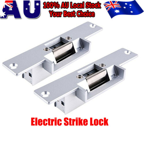

Does the motor just move a door handle to operate a door latch so that the door can be pushed open?
Did you consider an electric door strike?
Tom... :slight_smile:
