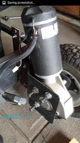

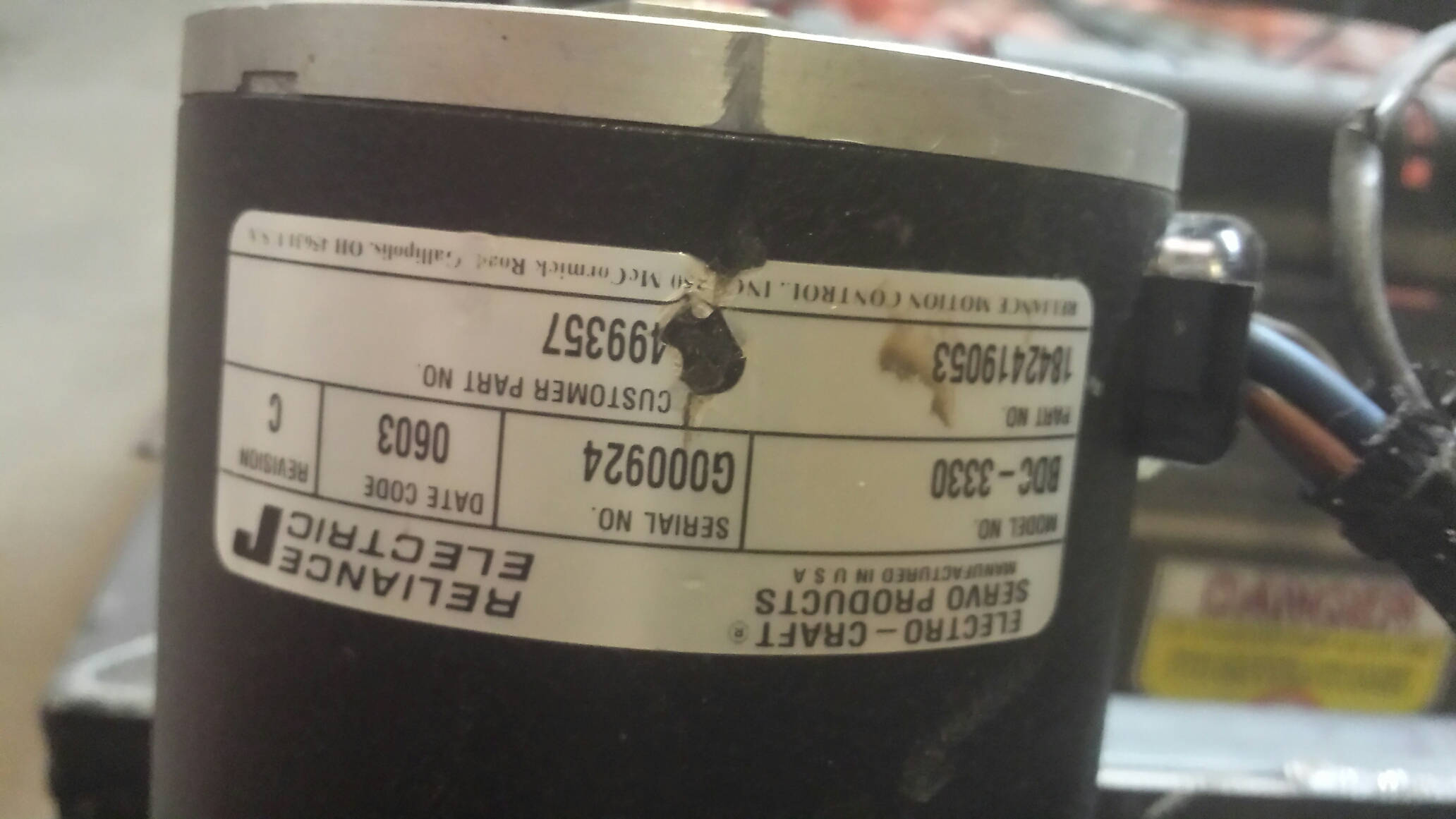

Is this a Servo or Brushed dc motor? It came off of a wheel chair. 4 wires to the motor. I know it says "servo products" on it but I'm not sure if it is.
The closest I've found is a forum. WheelchairDriver • View topic - ElectroCrafy model BDC3330... But I'm not sure that really answers one of my questions. Can I power that motor with a Sabertooth dual 25A motor driver? Or any other cheaper driver? I've used 2 wire dc wheelchair motors before but not with 4 wires.
The two spec sheets from the factory:
http://www.electrocraft.com/files/electrocraft_legacy.pdf
Don't seem to tell me on my specific motor. = BDC-3330
Any insight would be appreciated.
Here are pictures of the motor and connector.
Maybe a brushless DC motor? Maybe those are three power leads and an insulated set of hall effect sensor wires?

It would be nice if there were a picture of the entire motor from a couple of different angles - but in short, if you don't see and brush-cups (to allow replacement of brushes), then it is likely that these motors are brushless.
If that's the case, then I agree with SurferTim - an R/C ESC would be your best bet to control it - at least for the lowest cost (controllers for these large brushless motors exist - Roboteq is one source - but there are anything but inexpensive).

big BLDC motor with hall sensors.
page 53 in http://www.electrocraft.com/files/electrocraft_legacy.pdf
1.15Nm, 7500 rpm max (not the recommended operating speed, note, but the safety limit).
Depending on the windings (schemes A and B are listed) its aimed at 50V or 100V I think, and
looks quite capable of 500W or more.
So no its not brushed and needs a sensored BLDC motor driver and suitable high voltage
supply (depending on which winding version you have).
It has 8 wires, not 4, 3 phase wires and 5 for the hall sensors.

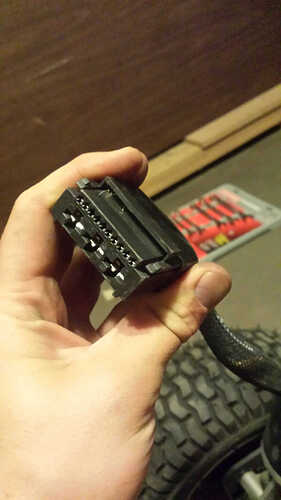

Hey - good catch - and looking at that connector, it's pretty clear that the three lower pins are for the windings, and the other pins (only some, likely?) are for the sensors. The picture of the motor, though, only seems to show the wires for the windings - plus a (black?) wire going off in the distance (?).
We definitely need more and better pictures - but yeah, this is a brushless motor.

No, quite the contrary, DC is a brushed DC motor, B or BL means brushless. The DC
electric motor was around for 100 years before brushless motors came along, no-one
ever bothered calling them "brushed DC motors" till then because all DC motors always
had brushes.
PMDC = permanent magnet DC
BLDC = brushless (permanent magnet) DC

The motor has 8 wires as I said, 3 phases and a bundle of 5 wires for the hall sensors -
look at the connector.

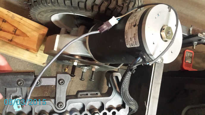

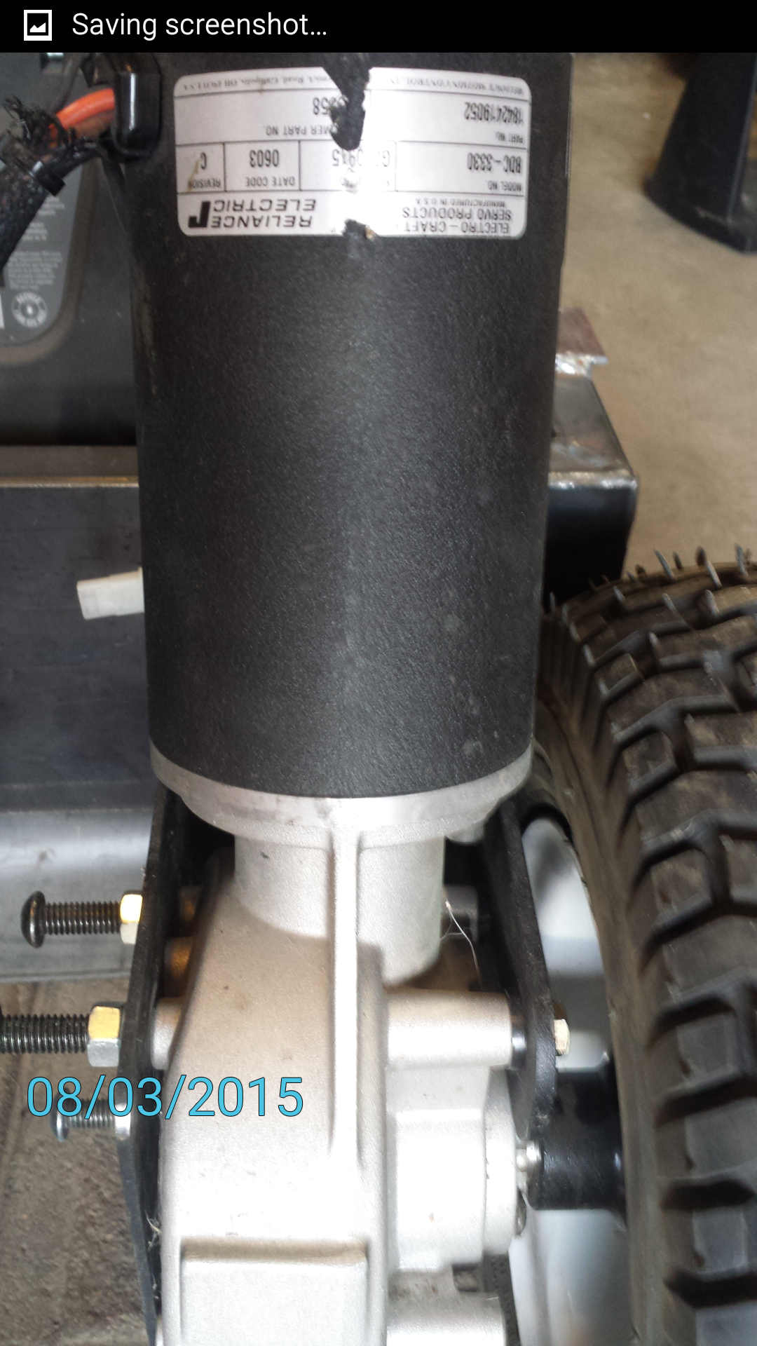

Here are some more pictures. Just to make sure everyone thinks these are BLDC motors and I can get a consensus. If they are brushless I might have to get different motors.
Motor5.jpg shows what those extra wires went to I think. The bottom part of it Onegoes to a safety lock type mechanism that if the chair's frame isn't connected then the motors won't go (my guess). Connectors fit but not sure if that is truely where they go, I never had all the parts. So 2 wires to chair lock and 4 more wires directly to the motor. Some pictures show motors with brake cover on and some with brake cover off.

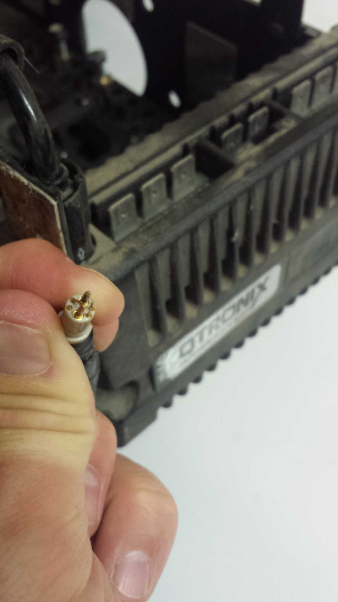

I also put a picture of the original controller and 6 wire joystick connector. Any ideas how hard it is to use the original controller with arduino?

BLDC as we said, no doubt. Have you measured the winding resistances yet?
Yes the extra end section with two wires is the brake, its a big solenoid that pushes against a spring
to release the shaft brake. Usually takes 0.5 to 1A at 24V, and you can just remove that section
if you aren't needing a safety brake.
