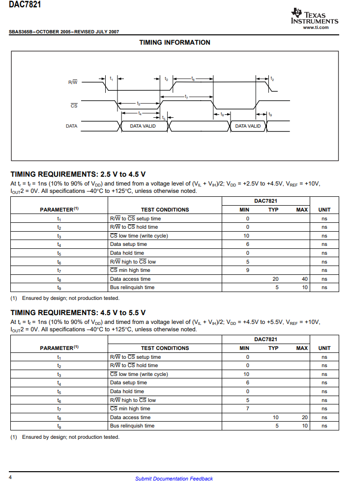

Yes, thats where I started looking into the timing diagrams of the DAC7821 which I plan to use. On pg:16 it says that the data is loaded into the input register when the clock (CS line) goes low and is latched to output DAC register when it goes high. In that case, I guess I should keep the clock low as long as the Mega is done outputting both bytes on the output lines and then pull clock to high just for long enough for 2 bytes to be written (as per the datasheet must be >=10ns). I can use the same clock input that I use with MEGA and delay it the amount of time (62.5ns as per your info + whatever time MEGA takes to latch out the data onto output lines) and then invert it for proper operation of DAC. At the moment my clock is 1us pulse.

Looking at the datasheet I would do things in this order
  • Set R/W low to signify loading data (if you never read back the data this could be permanently low).
  • Set CS low
  • Write the data to the I/O ports
  • Set CS HIGH to cause the data to be loaded into the DAC
I don't think the timing of any of these is critical as long as they are done in the correct order. The DAC can operate faster than the Arduino.

Robin2:
  • Set CS low
...R
I am thinking more like writing data to I/O ports before setting CS to low, that way data is available for DAC on its input lines to load into the input register as soon as the CS goes low and wait for like 20ns before switching CS to high.
