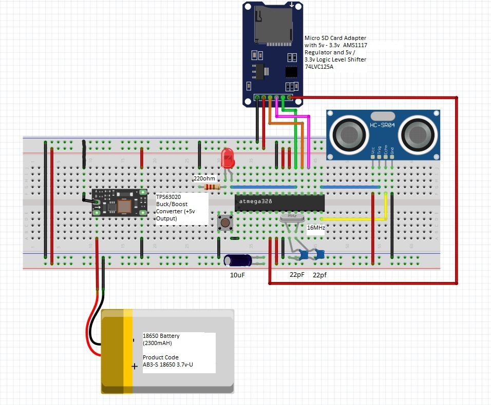

Hi I have been trying to solve this issue all night and finally figured I would see if any of you folk know what might be the issue. I am trying to build a battery powered data logger that uses the HC-SR04 ultrasonic sensor to measure the water level and then log it to an SD card.
Having got the HC-SR04 measuring well and logging to the SD card connected to an Uno powered via USB from my laptop I migrated it all over on to a bare bones arduino on a breadboard which again worked as intended when the circuit was powered via the 5v and GND pins of the Uno board.
My issue has come about since I switched my power supply from the 5v/GND pins from the Uno board to being powered from a 18650 Lithium Battery boosted through a TPS63020 buck/boost converter board like this.
The SD card continues to log values absolutely fine however these values are all "0.00" rather that the readings that should be coming from the sensor hence I don't think the sensor is returning values correctly for some reason.
I initially thought it might be noise from the boost converter however I tried connecting a USB cable 5v and GND wires from my laptop to the input of the voltage converter and it worked fine. I then thought it might be that with the USB input the the voltage converter being the same as the output it may reduce the noise so I took another buck converter set to an output of ~3.3v and connected the USB power supply to the inputs of that and the outputs to the boost converter and it also worked fine. I have also tried other boost modules using different IC's and circuit architectures non of which have worked with the battery but all of which have worked with the USB power supply.
Notes:
Battery I am using is this AB3-S 18650 2300mAh battery with PCB protected (though I have tried a range of other batteries).
Battery voltage is currently around 4.09v and does not drop by more than 0.02v when load is applied.
I have tried adding a couple of 1000uF electrolytic capacitors as in the past when I have had issues where modules draw short bursts of higher current, this has resolved the issue.
Essentially I am at a loss as to what is the issue and would really appreciate some advice. I have included the circuit setup (with the battery) and the code I am using below. Hopefully it all makes sense but feel free to ask questions if not.

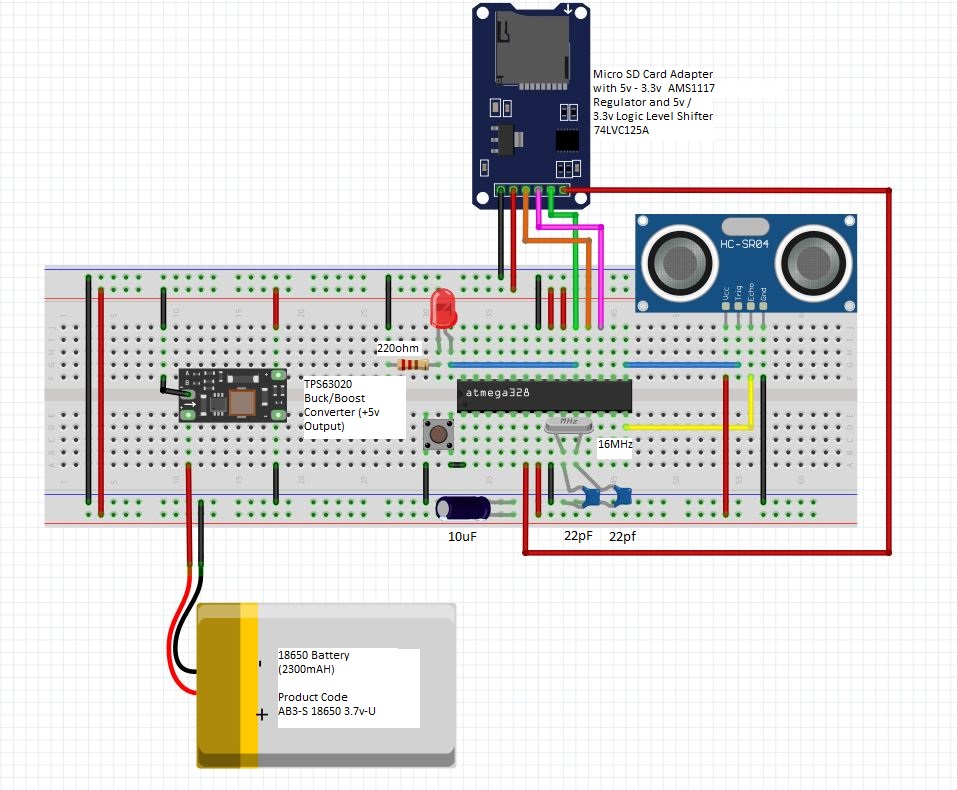

Apologies. I had made a drawing error in drawing up the layout please see the actual connection for this wire (it is in fact connected to ground)
I cannot find any decoupling caps for the 328, but you have them in your real circuit?

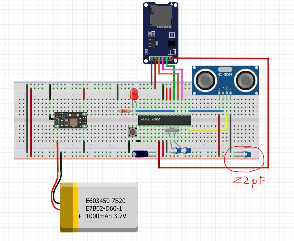

Just to confirm I have added a 22pF ceramic capacitor between the 5v and GND rails on the breadboard close to where the HC-SR04 connects and there is no change in how it performs. It still works flawlessly when connected to any USB power supply but reads 0mm whenever any batteries are used to power the boost converter.
Not really sure what else to try. I read somewhere that the HC-SR04 with a 4MHz crystal sometimes doesn't work well when powered with anything more than 4.9V (not sure it this is true and if so why) but in both the battery and USB powered scenarios the voltage provided by the boost converter is the same (4.98V) and it works fine when it is powered from the USB.

Can you put together a more detailed diagram, centered around the 328p? I'd like to see the bypass capacitors etc. Also, how do you connect a stand alone 328p to USB?
Hi, Sorry I am not understanding. Where should the bypass capacitors your are referring to be?
Below is an updated schematic with the 22pF cap across the 5v/Rails adjacent to the HC-SR04 connection I will go hunt for a cap around 0.1uF - 1uF and see if that makes a difference. Should there be additional caps somewhere else? If so where and what values would be recommended?

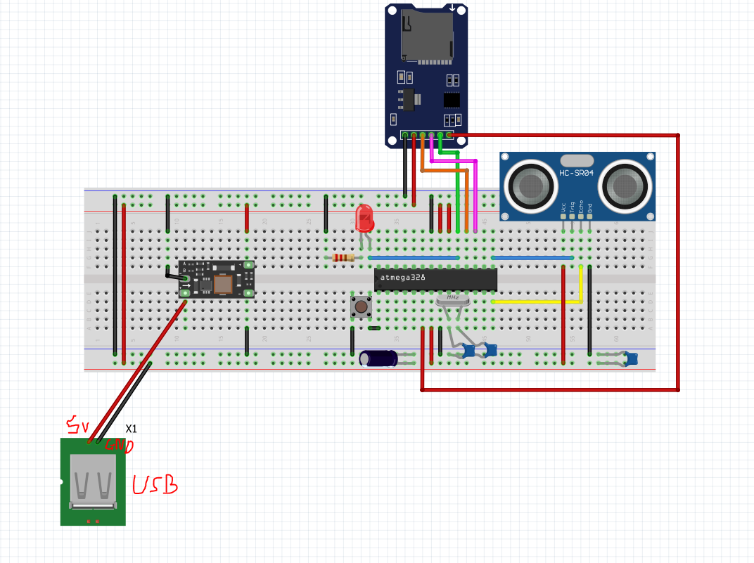

In terms of when it is connected to a usb power supply. Essentially it is a USB cable with one end cut off it and the 5v and GND wires broken out and connected as shown below. I just plug this into my computer or a usb wall socket. Appreciate it is rather quick and dirty as a power supply but it has worked well for me in the past and seems to work fine for this as well.

Have you figured out the problem yet? Circuit works fine with USB power, and not with the TPS. There's already a bunch of caps on that regulator, so you'd think they had that under control, and not that you have to add filter capacitors. I prefer Mouser, but DigiKey, Farnell and RS components also have a solid reputation. Neither of those are cheap, but on the other hand you always know that you get quality.
Anything with a clock can cause the problem such as the Buck Converter, processor etc.
Ah ok, thankyou! That makes much more sense. I will order some 0.1uF and 1uF caps and give that a try. I assume they should be as close as possible to the AVCC and VCC pins as possible?
I'm still a bit confused as to whether you think it is the converter or the processor or the HC-SR04 that is creating the noise that is causing the issue.
In terms of the TPS and the other boost converter I have tried which is a MT3608 (See link at bottom), the circuit works fine when USB 5v and GND is fed into the VIN and GND respectively (not strictly needed as I understand it as the USB is already 5v) but I dont understand why that would not also produce problematic HF noise if the converters were creating that when the converter was connected to a battery?
