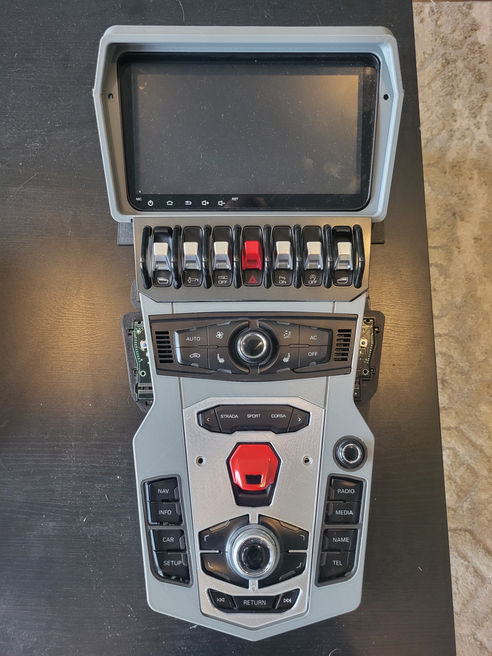

Quick background... I'm building a replica Lamborghini Aventador and need to hack an Audi component. Specifically, I'm planning on using the buttons from an Audi infotainment system to control a generic Android radio/nav system. (My prototype center console looks quite similar to the Aventador center console, but uses a mix of Audi and Lamborghini components, combined with various 3d printed parts). Ultimately, when a button (or control) is touched, the button module will send an rs232 serial code sequence that is picked up by an Arduino Mega. The Mega would then simulate a steering wheel button being pressed, which could be mapped to the Android controls.

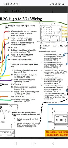

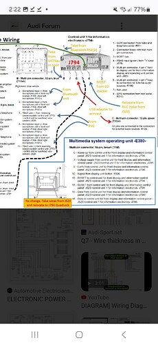

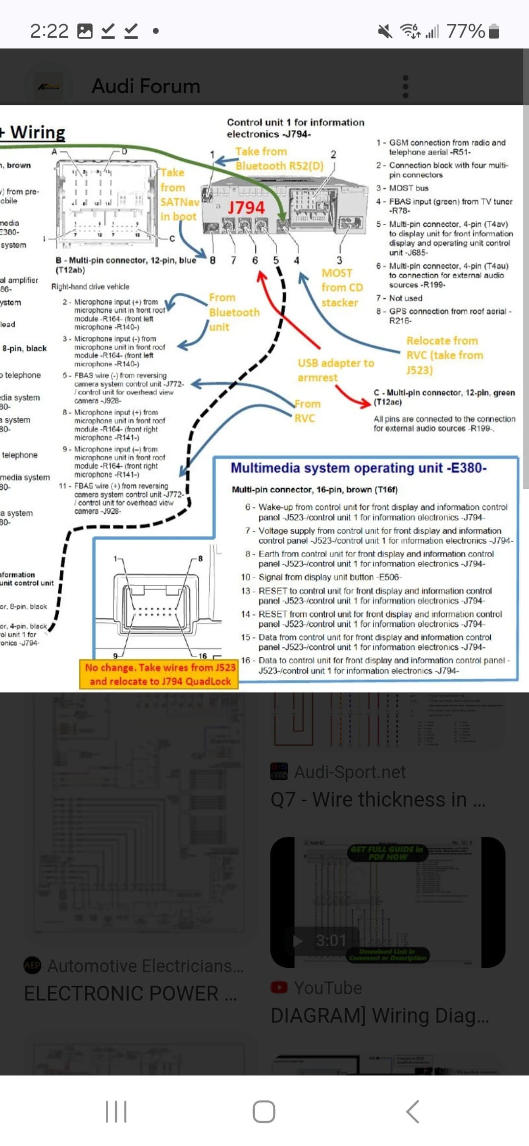

This document from the VAG says that there is a private CAN bus between the J794 and E380.
Unfortunately, I have different models for the J794 and E380 than what is shown in that document. I wish they hadn't used the same name for the parts. My pins are quite different. I've gone through dozens of tech documents and they all show the pins as "data to" and "data from" with respect to the connection between these particular models. The CanBus lines don't go to the E380. I've worked with CanBus and it is a differential signal. When I scope these two lines (and there aren't any extra pins that I haven't accounted for) they are clearly two separate serial lines. When a button is pushed, I get a serial data signal from the E380 on one line and then I get a response from the J794 on the other line. If it were a CanBus signal I would see a differential signal on both lines as each unit talks. I'm not sure how to post pictures, otherwise I could show pics of everything. The E380 has 7 pins. 12v, gnd, wakeup, reset to J794, reset to E380, data to and data from.
