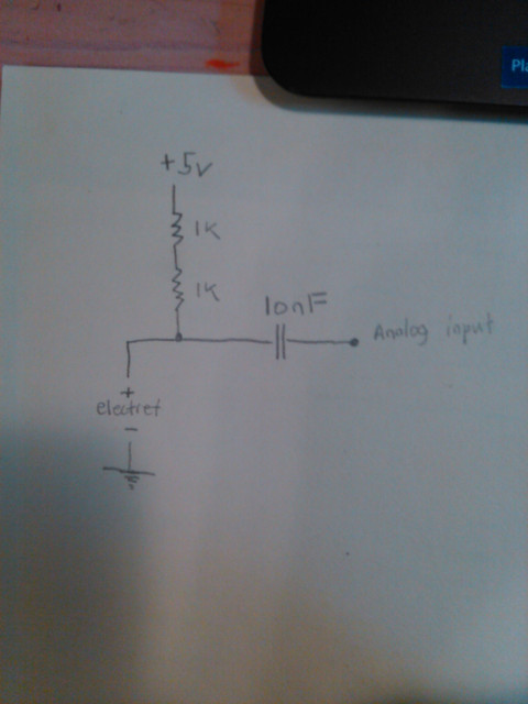

So here is my simple circuit drawn out (as well as breadboard connections) without any gain amplification that I connected to the A0 analog pin of the arduino UNO.
I used 2k resistance as this seems to be roughly the value used for biasiing the electret's JFET. As the way I understand it, the capacitor allows the AC voltage from the electret microphone to pass (within mVs range) while blocking the DC current to the analog input.
Powering this from a a 5V wall adapter, the circuit seems to work. On my oscilloscope, I see low voltage waveforms from clapping, speaking, music etc.

The capacitor is connected to a very high impedance point - the analog input. You need a pull down on the analog input .
Also the signal into the A/D is an AC waveform - that is unsuitable and may damage the Arduino.
I suspect the internal protection diodes and clamping the waveform in one direction resulting in the capacitor charging. There will also be a switch on spike , which will only discharge slowly.

Do you mean something like this? Is the point of the resistor (just assuming a 1k would be fine) to discharge the S/H capacitor after switching back to the input signal?
I read a little bit about op amp biasing to push an input signal above ground by a fixed amount. This would be the fix for the AC coming from the electret wouldn't it?
With the pulldown resistor added I am thinking this would take care of this?

The pull down resistor will help.
I would go for amplifying and rectifying the signal. If you google “ op amp precision rectifier “ you’ll get some circuits.
There are lots of problems with your approach.
  1. The resolution of the ADC, using a 5V reference, is about 5 mV. The microphone output may not vary by much more than that, so you need an amplifier, or use the 1.1V reference to get about 1 mV resolution.
  2. Use a larger load resistor on the microphone, to get more output variation. 10K is common.
  3. In your test program, the sampling rate is determined by the serial Baud rate, which (at 9600) is very low. You are sampling the microphone output only about 200 times per second, so it is unlikely that you will detect an impulsive sound like a clap.
  4. You don't need a capacitor, pulldown or bias resistor if the microphone power supply voltage is less than or equal to the analog voltage reference.
I recommend to get an amplified microphone module like this one: SparkFun Electret Microphone Breakout - BOB-12758 - SparkFun Electronics.

ahh yes this is definitely a more efficient design. But for my purposes and after running some tests the DC offset added to the AC signal works well enough for me. perhaps version 2.0 I will go this route :slight_smile:
jremington:
So this is what I came up with including the relay circuit:
It works fairly well to just detect a clap! (I followed this pre-amp design, substituting in slightly different values for the capacitors/resistors with what I had on hand. I also added a low pass filter to hopefully cut the ADC some slack and avoid high frequency signals.

It seems to me that popping in that extra 100k resistor actually got rid of the slowly rising analog values seen on the serial plotter. Even after the amplification stage and getting rid of below 0 ground signals they still seemed to slowly rise until I put this resistor in parallel.

Relay circuit is wrong. Now the relay is getting about 3.5volt, and might not work reliably.
Relay coil must be connected between 5volt and collector, with emitter of the transistor to ground.
Must use a kickback diode (1N4148, 1N4004) across the relay coil to protect the transistor, cathode/ring too 5volt.
The indicator LED (without resistor) could go in the base line.
The 500ohm base resistor then has the double function of limiting base current as well as LED current.
