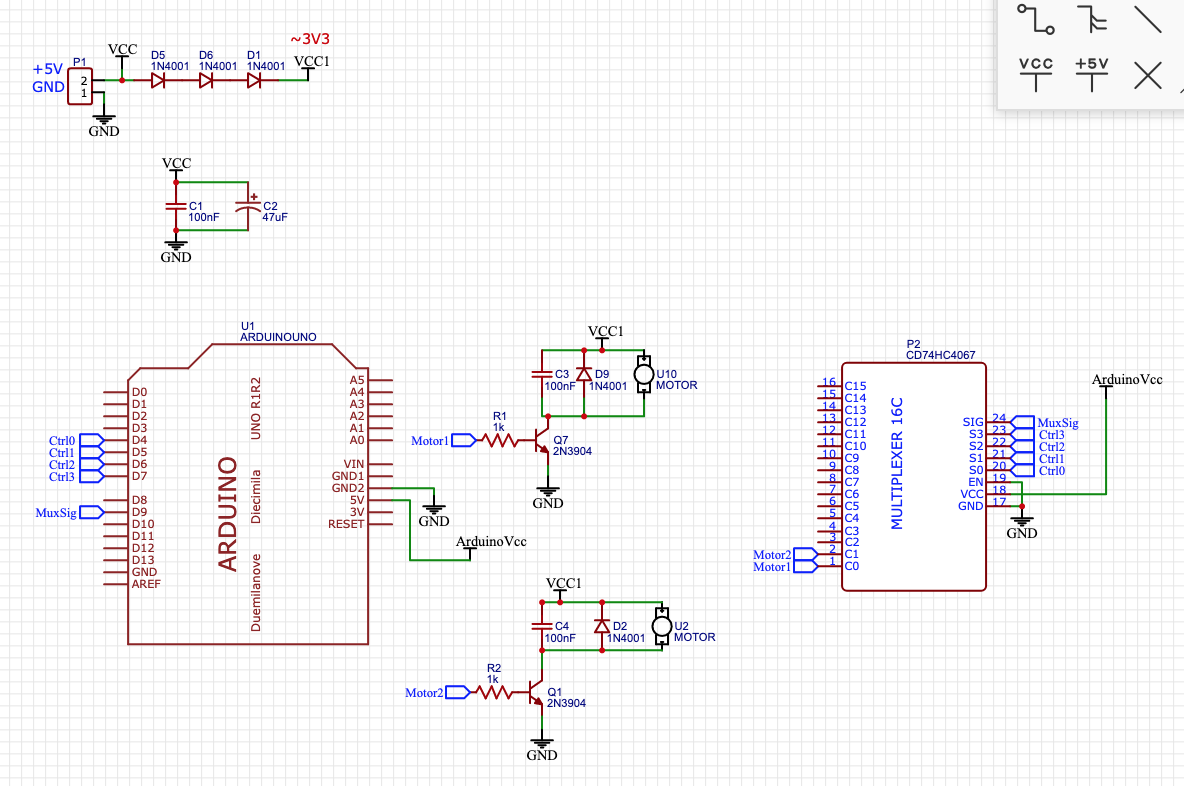

I have the following code:

this code should read the value for each motor coming from the pure data software. (I'm passing to each motor id numbers between 0 - 255)
The issue I'm facing is when I'm chanig the value of one motor (id A) it will stopped the other motor (id B) . (I'm using only two motors for the moment.
this wired as follow:
is there a mistake in code or wiring? or is just not possible all motors will worked at once ?
I might need to have an array of state so each motor will hae is own variable so the state can be rememberd?
A 4067 multiplexer is a 16 position selector switch (16 to 1 or 1 to 16).
There can only be one motor at the time connected to the signal pin.
To control/PWM 16 small motors at the same time you could use a PCA9685 servo board. If you do, then don't use the 1k base resistors, because that board already has 220 ohm resistors built-in. A 2N2222 is a much better choice for motors than a 2N3904.

ok I will look into PCA9685 or I will just use individual outputs from the arduino.
But how I could read continuous data from multiple analog sensor at once (pressing few of them at the same time) ? (using the 4067 mux )
