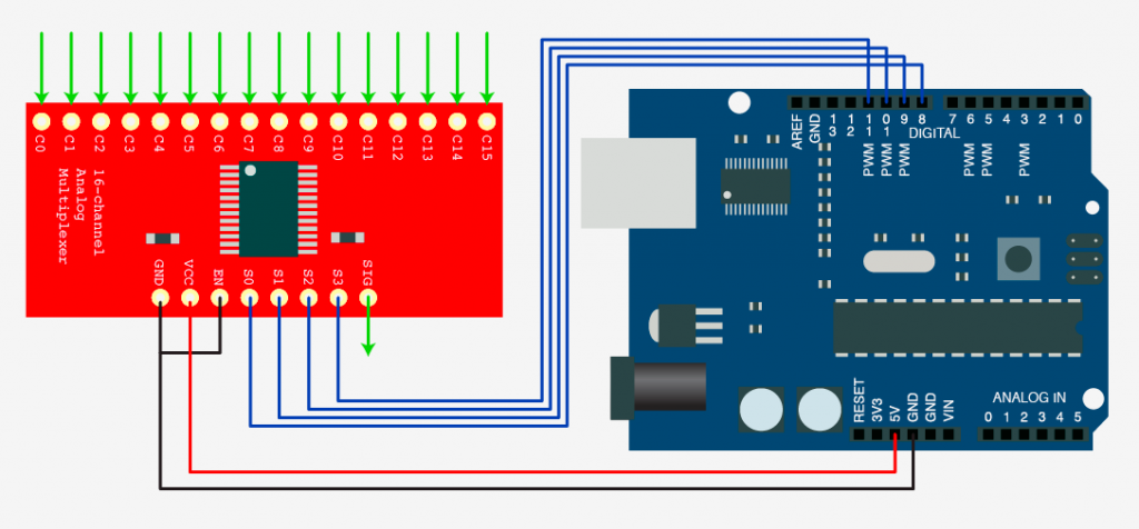

Hello,
I have an Arduino Uno R3 and a Sparkfun 16-channel multiplexer (CD74HC4067). I have a lot of potentiometers that I want to read values from at once, and the Uno and even the Arduino Mega don't have enough analog inputs. The multiplexer seems like it should be pretty simple to operate, just give it Vcc, ground, and a 4-bit channel selection to choose which of the 16 channels you want to access through the signal pin.
The problem is that when I hook everything up and try to access a channel, I can only seem to get gibberish out of the signal pin, even when I'm only trying to access one channel (in this case called elbow). I have mine hooked up just like this diagram from a tutorial I found (with the signal pin connected to A0, and the channel selection connected to pins 2-5):
And here is the code that I'm using:

I've also attempted to use the stechio Arduino multiplexer library, which simplifies the coding, but that doesn't seem to work either.
One thing that I tried was to just send the multiplexer the channel selection (0011) with NO potentiometers or other analog sources hooked up anywhere. Then I used a multimeter continuity test to see if Channel 3 and Signal were electrically connected, but they weren't, instead I would get a weird fluctuating resistance between the two.
I have a second multiplexer which seems to be exhibiting the same issue. Is there anything I'm missing here?
You can't use the VOM, how do you know the signal is 'gibberish' it is analogue right?
You have provided contradictory information.
You say you have the multiplexer hooked up "just like this diagram from a tutorial I found".
Except that you don't have the selection pins hooked up to the same pins, you're trying to control the /EN input even though it's grounded in the picture, and the picture doesn't even have the common I/O pin hooked up to anything.
So, if you do indeed have the multiplexer hooked up "just like this diagram from a tutorial I found", I'm not at all surprised that you're getting nonsense.
Show us your connections. Not some "it's just like this except it's totally different" picture you plucked off the internet.
Oh, and you've made no mention of grounding all unused inputs on the multiplexer. You are grounding all of them, right? You're not leaving CMOS inputs floating and expecting things to work properly, right?

I apologize that my post was very unclear. As I had said, I hooked up the selection pins to channels 2-5. I understand I should have been clearer that the picture that I provided has those pins connected to 8-11, whereas mine are different. I declared 2-5 as the outputs in my code, and hooked it up as such.
As for the enable pin, I wrote in my code to set it LOW, which I had assumed (perhaps wrongly) would be the equivalent of grounding it, however I will point out something that I should have mentioned in my original message which is that I did try the configuration of the enable pin as depicted exactly in the illustration, where I connect it directly to ground, but I had the same result.
For the I/O pin, as I also said, I hooked it up to A0, but again, I could have made that a lot clearer. I was unintentionally very ambiguous when I said that mine was hooked up "just like" the picture.
However, I think you may have illuminated what could be the source of my problem. I did in fact leave the other channel pins unconnected. I actually did not know that leaving the CMOS pins like that would cause an issue. I had assumed that electrical continuity between the channel pins and the signal pin was simply facilitated and switched by the Mux, kind of like transistor opening and closing, but I see now that my basic understanding of the device was likely flawed. I will attempt to remedy that and see if it fixes the problem.
Analog mux I/O in CMOS is kind of "different". It's not like leaving a CMOS digital input pin floating, which is a definite do not do and will cause all kinds of problems. But I've never been comfortable with the idea of leaving unused analog I/O pins floating and always tie weakly them to either Vss or Vdd.
What analog level have you got applied to the input channel on the 4067 that you are attempting to read.
