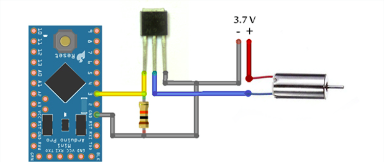

We are using coreless motor and want to operate four of it being controlled by MPU6050 using arduino nano and NRF module for communication.
We have used a below shown circuit diagram but no success. Additionally, there is no MPU6050 circuit attached to it. However, we attached it with our logic but there is no success again.

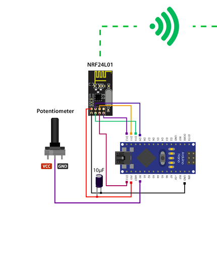

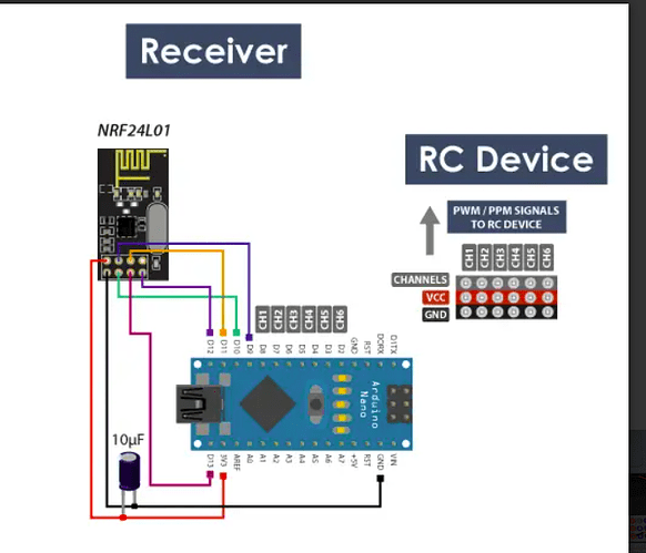

Then we tried below schematic and its code. This is for glowing LED light. And it did work for us on transmitter as well as receiver end, but, without MPU6050. We want to add MPU6050 and struggling with the code and its addition.
Schematic of Transmitter and Receiver

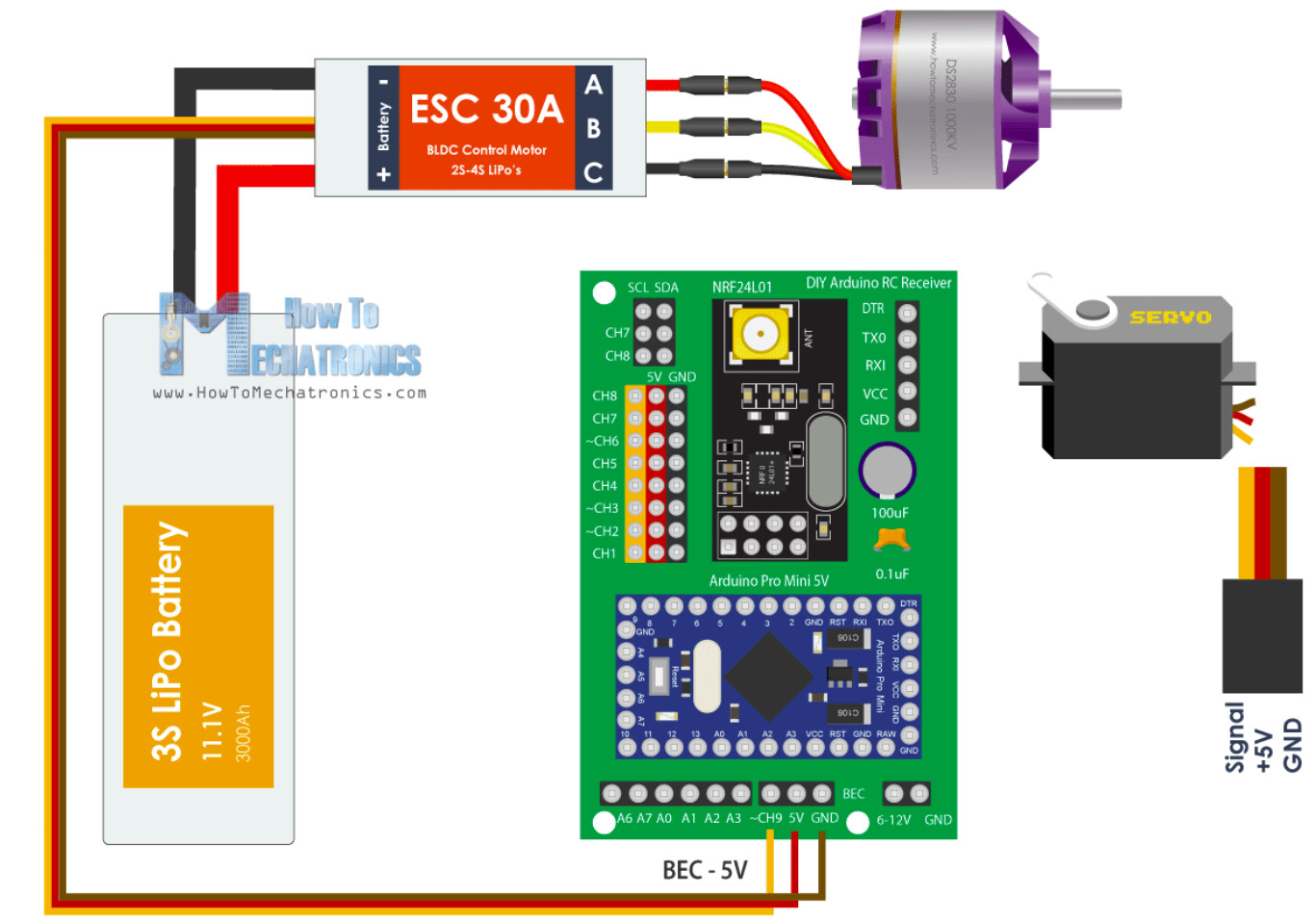

This is a circuit of transmitter to check servo motor operation. (Image 1)
However, we have made some necessary changes in this circuit. In our test, we didn't use MPU6050 in transmitter circuit. So our circuit looks like this (Image 2).
We have not made any changes in the code and used it as provided by the image 1 circuit developer.

FOR THE RECEIVER :-
Circuit and the code provided were used directly without any changes.

  if ( currentTime - lastReceiveTime > 1000 ) { // If current time is more then 1 second since we have recived the last data, that means we have lost connection
    resetData(); // If connection is lost, reset the data. It prevents unwanted behavior, for example if a drone jas a throttle up, if we lose connection it can keep flying away if we dont reset the function
  // Check whether there is data to be received
  if (radio.available()) {
    radio.read(&data, sizeof(Data_Package)); // Read the whole data and store it into the 'data' structure
    lastReceiveTime = millis(); // At this moment we have received the data
  // Controlling servos
  servo1Value = map(data.j2PotX, 0, 255, 0, 180); // Map the receiving value form 0 to 255 to 0 to 180(degrees), values used for controlling servos
  servo2Value = map(data.j2PotY, 0, 255, 0, 180);
  servo1.write(servo1Value);
  servo2.write(servo2Value);
  // Controlling brushless motor with ESC
  escValue = map(data.j1PotY, 127, 255, 1000, 2000); // Map the receiving value form 127 to 255 to  1000 to 2000, values used for controlling ESCs
  esc.writeMicroseconds(escValue); // Send the PWM control singal to the ESC
void resetData() {
  // Reset the values when there is no radio connection - Set initial default values
  data.j1PotX = 127;
  data.j1PotY = 127;
  data.j2PotX = 127;
  data.j2PotY = 127;
  data.j1Button = 1;
  data.j2Button = 1;
  data.pot1 = 1;
  data.pot2 = 1;
  data.tSwitch1 = 1;
  data.tSwitch2 = 1;
  data.button1 = 1;
  data.button2 = 1;
  data.button3 = 1;
  data.button4 = 1;
We have tried above transmitter and receiver circuit with servo motor. The servo motor operation is working successfully. However, when we connected coreless motor, it didn't work. We did this trial with the following MOSFET/transistor.
  1. IRFZ44N
  2. IRF9540N
  3. TIP122 (Transistor)
Can you operate the motor directly? Can you operate the motor through the shield (without the tx/rx devices)?
Yes. The motor is operational without tx/rx and in direct run.
We have not tried operating the motor in TX-RX form, without MOSFET.
If the motor works directly, then you need to make the wireless devices work.
Yes. That is what we are trying.
Not that clear ( about the four motors ):
  • you have 2 servo and 1 brushless motor and they work ok
  • you are trying to add 4 'coreless motor' ?
  • you want to drive these motors using a simple mosfet/transistor ( and not a proper driver )?
  • do you need to regulate speed/direction of these motors ( or are simply used on/off in one direction )?
  • you didn't include the schematic of how did you connect these motors ( one is enough, handwritten is ok too )... so can't be more precise
  • the code you posted does not include these motor's control... so can't be more precise
Do the NRF need antennae?
Purpose - We want to operate four motors in sync. with each other.
Our components (so far) - Arduino Nano, NRF24L01, 4 coreless motors, MPU 6050, MOSFET/Transistors
We have only 4 motors to operate. For trial, we used servo, to check the operation.
We want to drive this motor with mosfet/transistor. What is that proper driver? Are there any drivers available for coreless motors?
Yes. We want to regulate the speed and that should happen in sync.
Schematic
We have no idea about code .
Do you need to control also the direction of the motors ( the simple mosfet as shown, can't do that )?
What is the power of these motors ( how much current )?
You can drive these motors with a 'driver for bipolar motors', but should have a low drop if you intend to power with 3.7V ( generally with mosfet output stage )
These mx1508 are 1.5A 2-10V and quite cheap ( but I never used ) or something similar, more powerful if you need more amps.
This is for a toy drone and so there is no need of bidirectional control of the motor. We just need to control the speed of the motor. Like what it is done in BLDC motor drone using ESC.
Basically we are using 720 coreless motor . The operating range of this motor is 3 to 5v and current is 0.14A (140mA).
Coreless Motor Datasheet - https://handsontec.com/dataspecs/motor_fan/Coreless%20Motor%20720.pdf
Under this condition, will MX1508 work for us?
Yes it can do, it is a low drop circuit and each one can drive 2 motors, with a 1.5Amax so plenty of margin.
I've never used it ( I'm using bigger one with L6205, bigger power but not good for lo voltages )
Okay.
I am wondering why I have never seen any circuit diagram connecting motor driver for motor operation. :thinking: and everyone using MOSFET/Transistor.
Never mind. As this is for toy, would you please suggest a driver that can operate all the 4 motors and is light in weight?
Yes you can use also a mosfet ( current is limited, so less problems ), but you have to use a 'logic level mosfet' as you are driving it at 3.3V ( for example the irfz44 you referred to in a previous post, is 'a beast' not well suited for this task ).
Also pwm max frequency will be limited by the output current of the microcontroller you are using.
