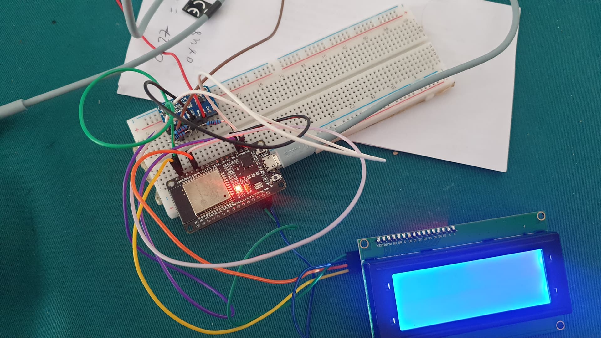

Hi everyone.
I did a montage with esp32 + ADS1115 and liquid crystal as this exemple from thissite :
However my display stills freezen. Datas are not. However i know that the adress stills reconized : 0x24 for display and 0x48 for ads. And Yes, i see inside serial monitor
Also as mentioned by this site i used :
his design adheres to the standard connection protocol for the ADS1115 chip. It features 10K ohm pull-up resistors on both the I2C and Alert pins, as well as a 1uF capacitor situated between the VDD and GND pins, functioning as a decoupling capacitor.
Could you tell me if the issue is that ads 1115 takes all the memory? is that as i used the same pins for two differents devices, there's a conflict? If you could tell me the solutions :slight_smile: thanks
The code here :

So, if it compiles and uploads, do you see any serial output in the Serial Monitor?
yes, i do inside serial monitor

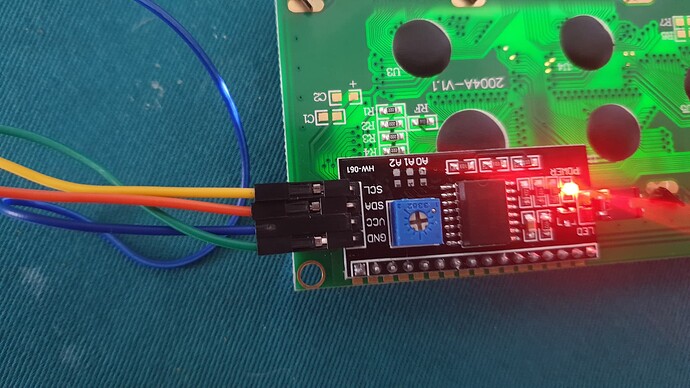

SDA and SCL lines connected to the correct pins on the LCD? Not reversed?

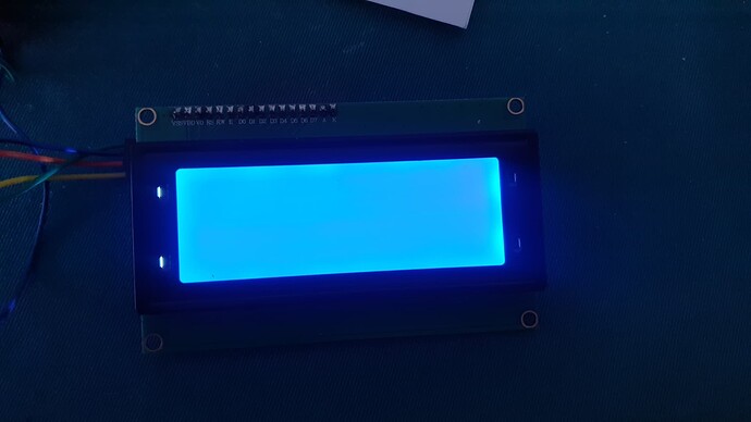

no! the display is on ( light) but no datas!
Have you tested both these devices separately?
yes!
Worse. Diagram unreadable, but almost looks like Data to power, power to data on the LCD. Need a better image to trust that, though.
@aydlinn can you actually read the pin designations on that diagram on your screen? I cannot.
I don't like the clear() call in loop, but I commented out the ads1115 stuff and your code runs and displays on my LCD.

My LCD states the working voltage is 5v. What are you feeding it?
with the vin pin of esp32
Have you run the i2c scanner sketch?
LCD should show 0x27
Seems to be using the ESP32 Vin for Vcc for the LCD
yes i get it!
Have you adjusted the pot on the LCD driver? I think that is backlight brightness. Maybe too high?
