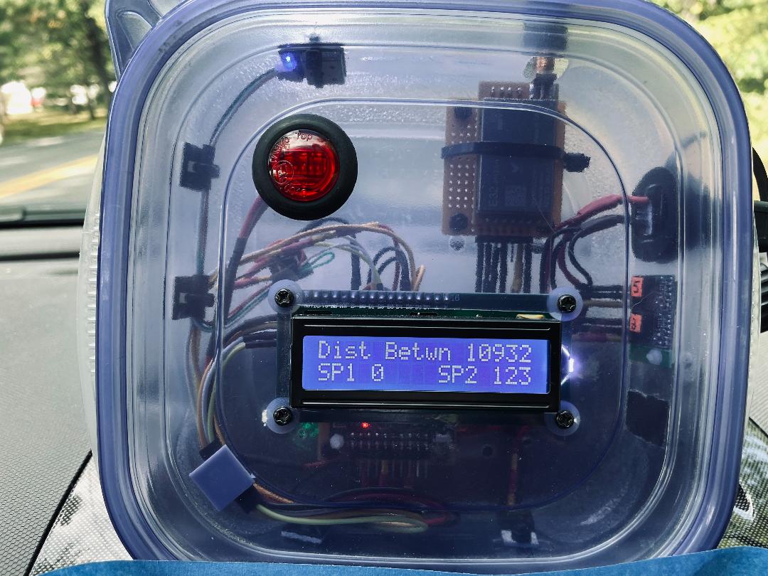

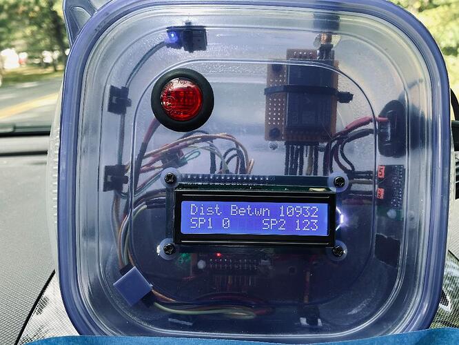

My project has been in transition for 5 - 6 years as I tinker with it. It original utilized a 16 x 2 LED display to show the distance between two LoRa radios sharing GPS position to calculate distance between and respective MPH data, image below is the beginning of my project.
Then I upgraded the project to utilize a 3.5in ILI9488 TFT display from Elecrow which utilized an onboard Wrover-B Micro similar to the LILY TTGO T7 Ver:1.3 Wrover micro to the original project. Thus I created a seperate sketch to pass the GPS data via I2C to display the positions on a map on the TFT display. I was very close to accomplish this concept when I thought the "espressif" was not listed in the AppData...\Arduino 15\ structure; hence my mistake to mess with changes that have now brought me to a screaming halt???
My project is created in two parts, the original portion utilizes a LILY TTGO T7 Ver: 1.3 Wrover micro with a 16x2 LED display. The second part of the project dropped the 16x2 LED display in favor of an Elecrow 3.5in ILI9488 TFT display with an onboard Wrover-B micro. This worked great, it just required passing the GPS data via I2C to then display; as the attached images show. My final goal is to show both pairs of GPS data as live pins to allow myself and friends where we are as we traverse the vast Manistee National Forest trails; 44.240925, -85.941956
