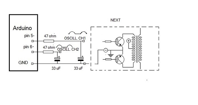

I'm trying to generate sinusoidal half-wave PWMs on pins 5 and 6. Then I will send the sinusoids to two bjt or mosfet connected in push pull and connected on the primary of a transformer as shown in figure 1: "Generatore sinusoidi Schema elettrico.jpg"
Now the outputs are connected, via RC filter, to the inputs of an oscilloscope. The code works perfectly and I get the sinusoids, only that each cycle lasts 120 mS while in Italy we have the mains current frequency at 50 Hz, so 20 mS per cycle: see "Generatore Sinusoidi funzionante con filtro RC.jpg"

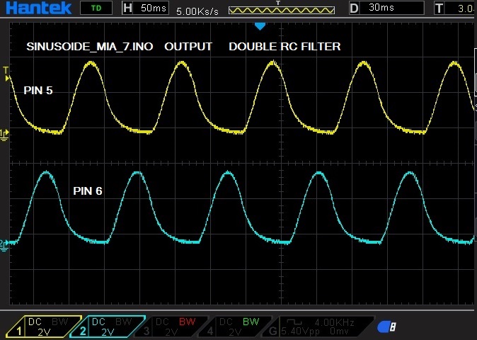

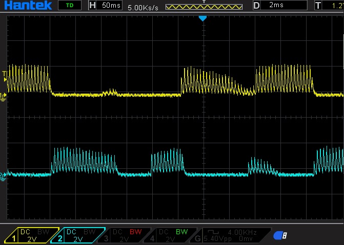

Let me describe the problem:
to get 20 mS I removed the printing instructions on the serial plotter Serial.println(sinPWM*) but at this point I get a*
mess visible in : "Generatore Sinusoidi NON funzionante con filtro RC.jpg"
I tried everything. I plugged in another RC filter to no avail.
Can anyone help me?

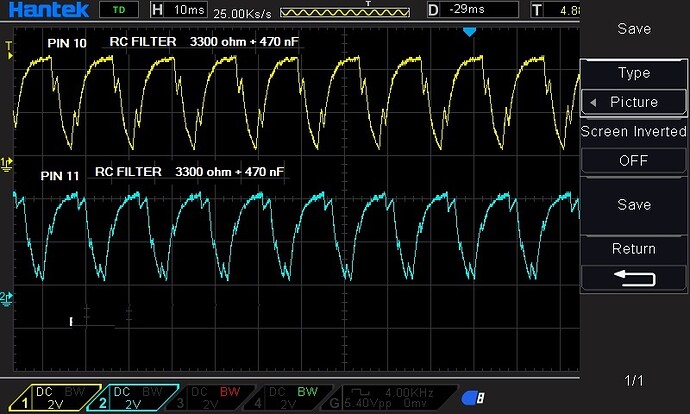

By connecting the oscilloscope on pin 10 and pin 11 I got the picture shown in "gcjr_code_pict_1.jpg", "gcjr_code_pict_2". A movie would have been better but it would have been too big.The pulse from min to max has a period of about 1 second.
In your other code the mathematical generation of the array was the same method used by the author of the array Pier Aisa as mentioned in my code.
Unfortunately I'm busy again today, but I'll be in touch in the next few days because I'd like to resolve this code problem.

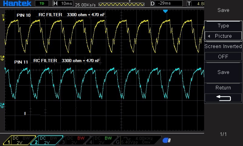

Thank you gcjr (your name is Greg ?) for your patience.
Now I got 20 mS semi-waves, but as you can see in the figure "gcjr_code_pict_3_20mS.jpg" the zero volt line is missing and the semi-waves are not in phase between pin 10 and 11 (the RC filter is now 3300 ohm+470nF).

Now I got 20 mS semi-waves, but as you can see in the figure "gcr_code_pict_3_20mS.jpg" the zero volt line is missing and the semi-waves are not in phase between pin 10 and 11 (the RC filter is now 3300 ohm+470nF).
is this with your code or my code?

i ran your code, captured and plotted the output from the serial monitor and see 2 positive side sinusoids. so the values look correct, but i don't have timing. based on your scope trace there's a problem.
i'll explain the issues I see with your code. the major issue is the sampling rate is not fixed, affected by prints and pauses. i think the minor ones need to be fixed, after you fix the sampling rate

another thing to consider is the PWM frequency (976 Hz on Uno)
several complete PWM cycles needs to occur before changing it for those values to have an affect. 20 ms / 78 = ~25 usec which is too fast.
you could try a smaller table, maybe 10-15 values

In addition to modifying the array reading code I have removed all the delay cycles from my main program, and I also attach the oscilloscope trace.
gcjr:
I think that's a good explanation, too. By tomorrow I'll try with fewer elements in the array.

what are the values of your R and C? i think you're filtering too much
gcjr:
gia
You guessed it, because my filter had a cut-off frequency of 54 Hz only: 820 ohms + 3.3 uF.
Now I'm using a filter with a frequency of about 100 Hz: 3300 ohm + 470 nF.
With the shorter array I was able to get a cycle much lower than 20 mS, so I can add delays in microseconds after each analogWrite to bring the cycle to 20 mS stable (see the picture and in the code delayMicroseconds(ulngMicroDelayT)) . Naturally these delays are calculated time by time based on the time taken by the last cycle.
I do not know if this procedure is correct.
But the waveforms at the oscilloscope are very distorted, and I don't understand why.

how did you get the "Generatore Sinusoidi funzionante con filtro RC.jpg" scope trace from your original post?
the last version of your code posted on July 12 still has the serial.prints() providing the timing. is there a version that uses micros()/millis() for timing?
presumably gcjr_code_pict_1.jpg shows both PWM outputs. why does the bottom (cyan) curve show an output that is predominantly HIGH with a very short period that is LOW. shouldn't that bottom curve be at ground (LOW) 100% of the time?
the waveform samples should have a zero as the last value output on each half cycle
i think the RC cutoff frequency depends on the PWM frequency which i previously reported is 976Hz (although I thought it would be much higher - 200 kHz) and not dependent on the frequency of the waveform (50 Hz).
based on "Sine waves from code 7 Double RC filter.jpg", where i suggested the RC may be too big, i felt that because when the wave form should have reached zero, it was still decaying.
it's conceivable that the inductance of you coil will provide sufficient filtering and maybe all you need is something to protect against BEMF.
gcjr:
From the code shown in the code window in the same post, with a filter 33uF+47 ohm. As you can see the cycle is too long, about 150 mS, because the array was too long.
I don't understand your word "still". the only version that uses micros()/millis() for timing is the last on July 13 because only with a short cycle < 20 mS i can apply the micro delays.
I dont uderstand this phrase for my fault. As I said, both traces, the upper one and the lower one, pulse at frequency of about 1 second from 1% to 100%. As I said a movie would be better to show this movement . If you need it I can upload a movie on Youtube to show the oscilloscope screen.
As you can see in my first post with a 102 Hz filter (47 ohm+33 uF) I obtain a perfect sinusoidal wave, without any attenuation. So I think I must cut all the frequencies over 50 Hz.
Yes, do you mean the coil of the trasformer ? I'll connect diodes to protect the BJT.
