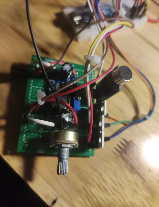

Hi guys, I'm doing my first project that uses Arduino to control a 5050RGB LED light strip with MOSFET.

I've tested it on a breadboard and It works fine, after that, I make a board that looks like this:
But when I power it on, The light should be off completely but it still shows a dim light:
I'm pretty sure all my wirings are done correctly and tested connectivity.
and also, the middle MOTFES seems to not work right because when I give 4.0 voltage to the gate, the drain only gets around 5v.
Wonder why is this happening, could anyone help me, please?

There are errors in your schematic.
In the sound module the + is shorted to GND;
And DO is shorted to + or GND.
Check if the PCB is correct.
Those FETs you used are not logic level FETs and do not achieve full switch on until you give them a 10V gate signal. It looks like the component spread you get with all components is allowing you to get some functionality with the limited gate voltage you have, but it is not very good functionality.
You need to use a logic level FET that will switch on fully at 5V. If you look at the data sheet you will see a parameter for Rsd(on) which is the resistance between the source and the drain when it is on. In the conditions column you will see what gate voltage this was tested at. You will see for your FET this condition was Vgs (voltage between gate and source) as 10V. This is where you have to look on a data sheet to see if it is suitable for using with your Arduino.
Do not be fooled by the threshold voltage, this is the voltage below which there is no conduction. Or in other words the voltage where the FET just begins to start conducting.
Nice but some of the labelling is wrong. The connections to the gate of the FET is labelled Analog In, where it is the Analogue Out pin, which on an Arduino actually a PWM output signal.
Sorry, I'm using the IRFZ4N Datasheet
From what I can see, this is a logic-level FET. I'm using easy EDA and just use whatever I found there, Sorry if this confuses you.
And for the "Analog in" I meant The PWM output from Arduino. I'm using a breadboard Arduino for this project so It's my way to say that it connects to the Arduino PWM output. The drain should be connected to the led's red, green, and blue pins.
Sorry, It was totally my bad and it was not a PCB, just a though hole board that I soldered myself so I checked all the sorting and the sound sensor works.

Guys, I might have found out why the light does not turn off entirely when I use analogWrite(pin, 0). According to this page The page, so I've changed the code fragment from this:

This will use digitalWrite instead of analogWrite when the value needed is 0 which turns the LED off completely. So glad this worked, but when I run this with Arduino nano, it gets so hot I can't even touch it. I re-wired the board to a breadboard that looks like this:
All the functions work almost fine but the overheating keeps worrying me. I'm using the step-down converter to power the POT, sound sensor, and Arduino.
Can you guys help me find out what the problem is?
Did you see on the datasheet that Vgsth (the voltage where the MOSFET barely cracks on) could be as high as 4 volts? Do you know that if you are powering Nano from USB, the output pin voltage is only about 4.7 volts? You have the wrong MOSFET.
Well, I noticed it and change the MOSFET to the H1061 transistor. Things now work but there is now overheating problem with the Arduino. I discovered the atmega328p does not heat up when the led is not turned on, maybe the problem is the analogWrite function? The microcontroller might be heating up because Its outputting 3 PWM signal all the time.
Transistors dissipate more heat than a proper logic level FET. Also what value is the base resistor? If that is too low it will draw too much current from the Arduino and heat it up. Your base resistor should be no lower than 200R.

Alright, let me first apologize for being ignorant. I am currently very new to this hobby and still learning a lot. The only FET I got is the Z44N. I ordered some IRF540 from china and it should take about a month to arrive. So using a transistor is the best thing I can do right now.
Thank you for the advice, I was using the resistors Incorrectly as the current will just go straight through without any resistance. I re-wired the board and all the problems are gone. I didn't know the transistor's thermal resistance is that much more than a logic level FET.
In electronics the term thermal resistance refers to the flow of heat between two places. For example from the chip to the component's surface or from component's surface to a heat sink, or from heat sink to ambient. It is measured in units of degrees centigrade per watt.
It has nothing to do with the heat generated by a bipolar transistor or a FET.
With a transistor when it is saturated, or fully on as it is called, there is a saturation voltage between emitter and collector called Vsat. This can be up to 2V for a power transistor, and is never less that 0.7V for any silicon transistor. So the heat it generates in watts can be found by the current times the Vsat.
For an FET there is no fixed Vsat but there is in effect one caused by the current flowing through the turn on resistance of the FET the Rsd, resistance between source and drain. This is why this figure is important and in general produces a very much smaller amount of heat for the same current flowing through it. However this Rsd is dependant on the gate voltage. So if you get a FET and you have not got enough gate voltage to fully turn it on, this Rds will be much higher that it could be and so it will generate much more heat than it should be.
The important figure is not the threshold voltage, it is the Rds minimum value. In the date sheet this has a condition against the parameter of a gate voltage and a current.
A logic level FET will have this condition of a gate voltage of about 4.7V. None of the two FETs you have mentioned are logic level FETs
