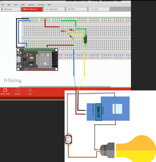

I have requested a move to the "General Electronics" part of the forum, because the board shown is not a Nano ESP32.
Please provide a circuit diagram.
The voltage divider should be powered from the 3.3volt pin of the ESP32.
Leo..

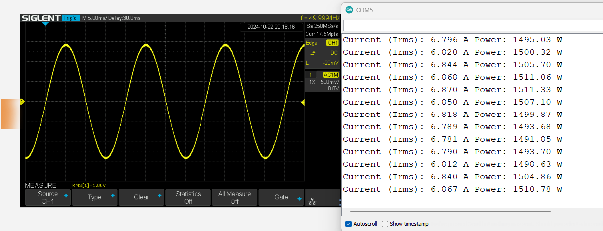

Even though your current transformer is rated at 30A, you won't be able to measure currents up to 30A using that 300Ω burden resistor.
To demonstrate this I have used a function generator to simulate the output of a current sensor.
I don't have an ESP32 board, so I used an Arduino Uno R3 for the demonstration.
For a 50Hz,1V RMS sine wave, and the calibration factor set to 6.667, I got the following results:
For a 1V RMS signal the 'simulated' current measurement is equal to the calibration factor. (within the limits of experimental error)
The peak to peak voltage is 2.828V - This is close to the maximum voltage that you could measure using a 3.3V ESP32.
So although your current transformer may be rated at 30V, you will only be able to measure say 6-7A using a 300Ω burden resistor.
If you wanted to measure 30A then you would need a smaller burden resistance, around 300Ω/5 = 60Ω. (and a new calibration factor should be calculated).

Connecting the voltage divider to V-in (wrong) could have caused (some off) that.
(post#2)
So what is the result after connecting the voltage divider to 3.3volt.
Leo..

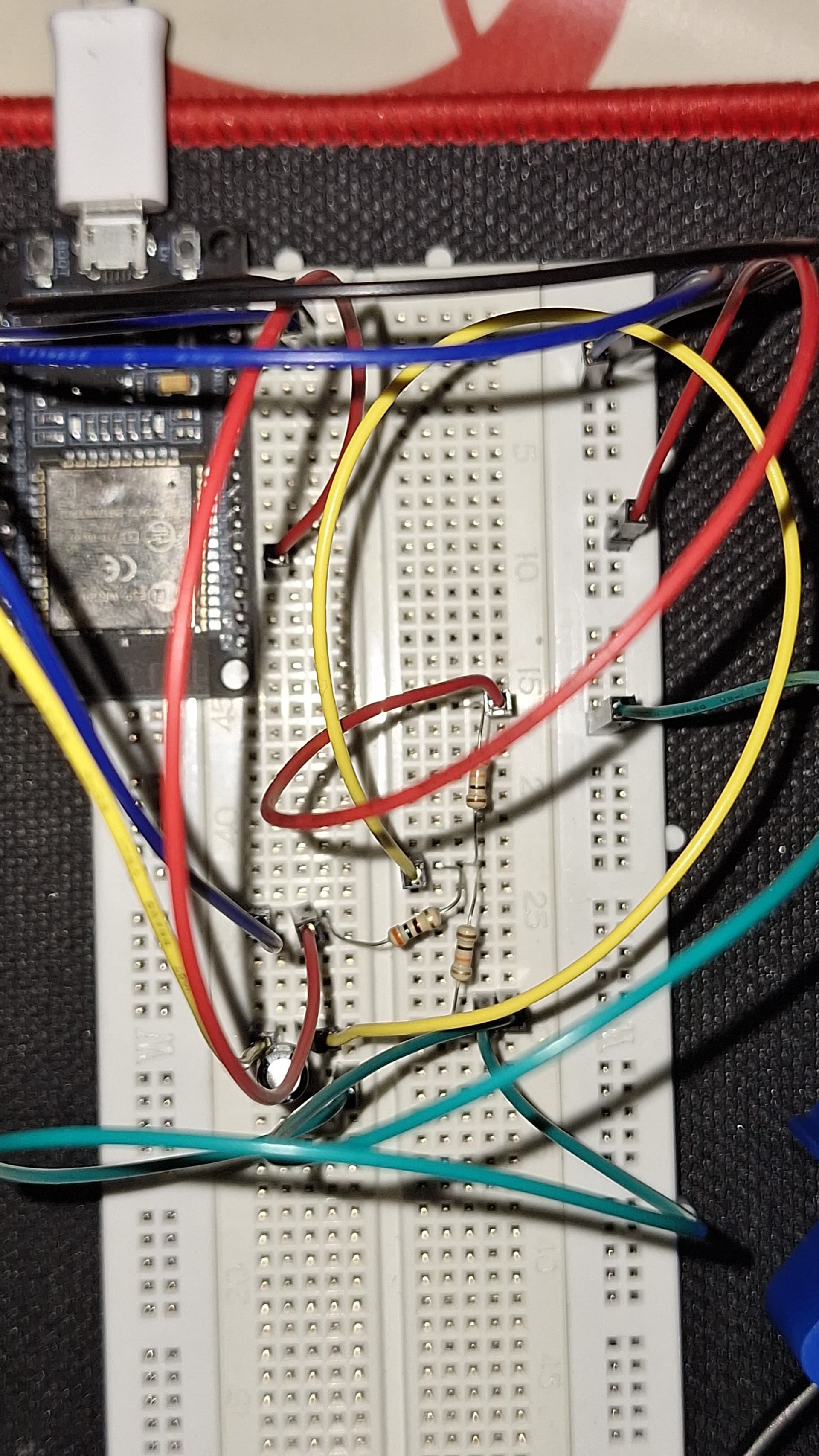

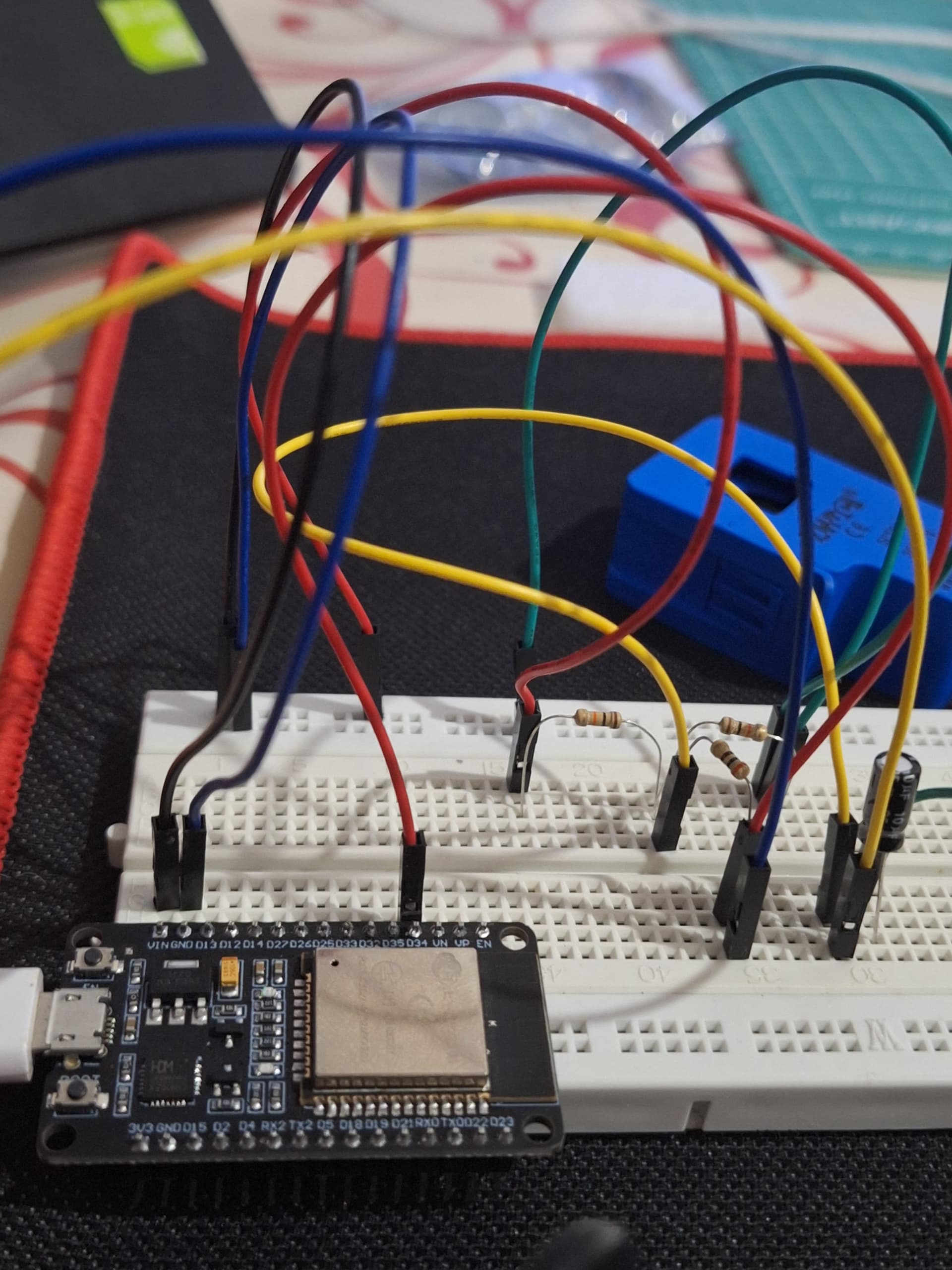

I set it up this way, maybe something is wrong?
Yes, not listening to the advice you were given.
Leo..
I have all the materials I need for the project, but could the problem be in the way I’m assembling them?
What would be the correct way? Could you kindly help me with that?
If you have a 30A/1V sensor, then you don't use a burden resistor.
So two resistors, not three.
Don't power the voltage divider from Vin.
Leo..
