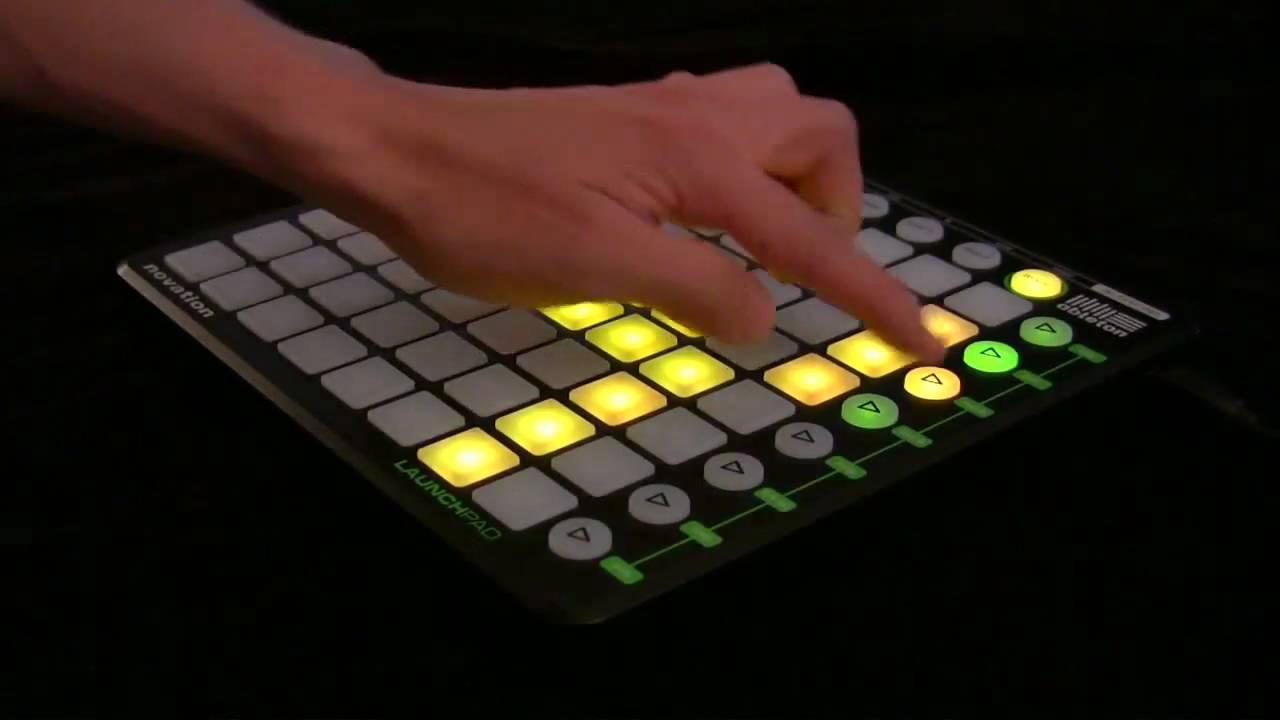

Make something like this is my idea, adding items that I will use that arent incluyed in the original
My english is so bad, and I cant say exactly the things that I think
Wow! I have no idea what was going on in that video, but it all looked very cool. I did only see 3 colours illuminating tbe buttons. But I think there were 81 buttons in total, not 64. I still think ws2812b leds are the way to go. It will be a complex project, so keep each part as simple as you can. The ws2812b leds may seem expensive compared to normal rgb leds, but when you add up the cost of driver chips, and the time you spend making the hardware and software work correctly, I think they are easily worth it.
